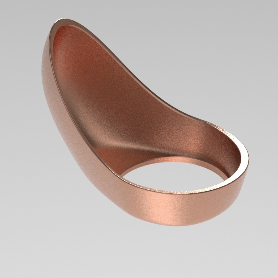

HowTo: Your Modelling approach of an Archery Thumb Ring?
It’s a bit off topic, it’s a project for a friend who’s new obsession is Archery. So we want to 3D-print one custom since this is really crucial and his girlfriend is the HR manager of Formlabs now (best SLA desktop printers and hugely funded)
made a little Rhino video where I’m at:
My question is, how you would model it to control this contour?
Hi Hannes,
Looking at the picture I’d consider this 3 separate shapes:
1 cylinder type shape for thumb (only needed at the end)
2 lower outer shape with upward protrusion
3 inner hollow shape looks like its sanded into a bowl.
Model these 3 separate with enough extension outward.
Next in the topview draw 2 freeform curves to be projected with history enabled. These projected curves one for each large shape define the edge from where the 2 shapes will be blended with a blendsrf.
With enabled history you can keep editing both the surfaces and curves untill you feel like you have a good setup.
Than on a copied set, trim excess surfaces and create a blend surface between them.
Undo and refine untill satisfied.

Hi Hannes,
As you suggest towards the end of the video, I’d probably model it in T-Splines/Clayoo - sub-d, but failing that I’d do it in much the same way as Willem has suggested.
The other way would be, working with the model you already have, draw a nice smooth curve/ring where you have your magenta sketch on the image you’ve provided. Pipe and then split it along the length, delete the bottom proportion of the torus. Extract Isocurve from the main model Split and hide the top section leaving a 2mm gap(ish) then use SplitEdge and BlendSrf with tangency or curvature to get you closer to the form you want. I’d try to get the pipe to bisect or come close to the two quadrants of the top and bottom ring of the model:
From there you can section the model, rebuild the curves and try again?
I had a quick look on Google and saw that someone was making one from a spoon - they’re the shapes I see in the images that you’ve provided and that’s where I’d start in this instance for the main 3x shapes rather than driving it with profile curves: https://tinyurl.com/lelba2w
Andy
Hmmm… I had a bit of time so I had a play around with it and went about it completely differently than what I wrote before :smiley:
It’s not that close with regard to the shape but you could redo it with history and get a better look but the principle is sound.
  • Sweep2 with two rail curves from ellipses that are drawn to the right dims and two profile curves too.
  • Rebuild the profile curves with the same number of points for the sweep - rebuild the curves to ensure you get a decent whole surface.
  • Project the ellipse onto a curved surface to get your smooth sweep you’re after
  • To get rid off the egg shape and make a better blend toward the back of the part add another couple of profiles for the transition.
It’s way too tall etc because I didn’t factor in the blended surfaces but I think it’ll work OK if you trim them back and start again.

Thanks so much @Willem @gman & finally @2DCube will take your feedback and work another version and get back with the results today we will print the 1st two versions.
here is a render of the last one. but it’s not done.

Good evening everyone. Some updates: fitting is custom hence perfect. But not yet proved in action. Printed in a durable resin hence printing speed of 5 hours. Will post a in field review later this week :smiley: As @wim said he critisised as well, that they unknowingly placed the supportive geometry on the front and he had to sand it. Will change it in a next upcoming piece. We will print v4 where there is a bigger lid for the string (the little bulge at the lower edge)
