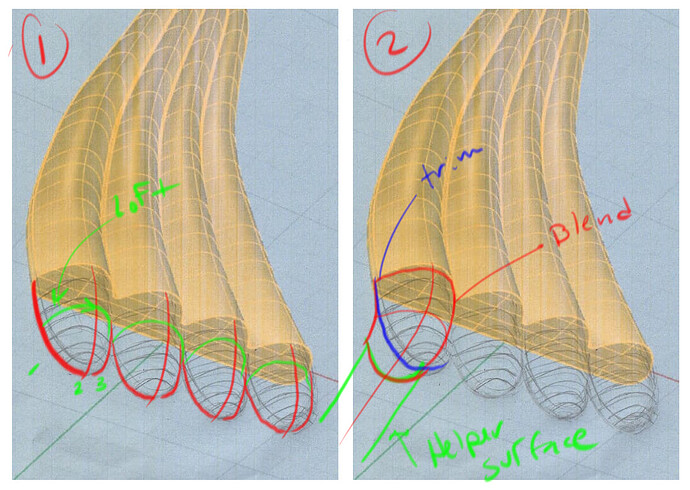

in v1, you will build 3 curves that touch at the apex, then loft and match srf to get your continuities.
in v2, you will build a helper surface that is rotated 90 degrees and then use a blend surface with history. Adjust as needed to get your proper shape, then trim it off flat.
Hi Kyle, the two alternative approaches are really interesting. I’ll try and do both for practice - thanks very much for the suggestions
One (simple and in hindsight, obvious) error I was making with loft was to select the curve rather than the polysurface edge. This prevented me from using the ‘match start tangent’ option. Sharing in case other beginners make the same mistake!
