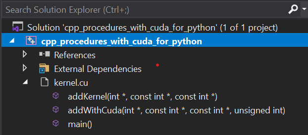

I created a CUDA project using the CUDA 12.0 Runtime template:
Using this template creates a project that already contains some working CUDA code in Kernel.cu
The included C++ CUDA example code Kernel.cu is simple; it adds 2 arrays. Most of the code is shown below.

After a build of this CUDA project there are the following files in the Release directory:
Kernel.cu happens to include a main() section so it can be run by itself. But the function of interest for calling from a C++ DLL is:
cudaError_t addWithCuda(int *c, const int *a, const int *b, unsigned int size);
This is what I want to call from my C++ DLL code. Once I get this working, then I should be able to expand this solution to add many other procedures to Kernel.cu and call these from my C++ DLL. Of course I will need to carefully consult the CUDA guide:

void cudaSuperProjector::sumVectors(float* c, float* a, float* b, int N) {
    cudaError_t cudaStatus = addWithCuda(c, a, b, N);
    if (cudaStatus != cudaSuccess) {
        fprintf(stderr, "cudaSuperProjector::sumVectors failed!");
  1. Then I went to Properties of the project and in General set value of Configuration Type to Dynamic Library (.dll). Now everything for creating a library is ready. I Built this project and in the X64\Release folder I found cudaSuperProjector.dll and cudaSuperProjector.lib. Then I created a directory C:\Users\Terry\source\repos\cudaSuperProjector\lib and in it I placed a copy of cudaSuperProjector.dll and cudaSuperProjector.lib from the X64\Release folder. Also I created a director C:\Users\Terry\source\repos\cudaSuperProjector\include and copied over cudaSuperProjector.h from the X64\Release folder.
  2. Then a separate C++ DLL Project called SuperProjector was created to call the sumVectors CUDA function in the cudaSuperProjector.dll. In this project a C++ file called SuperProjector.cpp was added:
#include <stdio.h>
#include "C:\Users\Terry\source\repos\cudaSuperProjector\cudaSuperProjector.h"
int main(int argc, char** argv) {
    float a[6] = { 0, 1, 2, 3, 4, 5 };
    float b[6] = { 1, 2, 3, 4, 5, 6 };
    float c[6] = { };
    cudaSuperProjector csp;
    csp.sumVectors(c, a, b, 6);
    printf("c = {%f, %f, %f, %f, %f, %f}\n",
        c[0], c[1], c[2], c[3], c[4], c[5]);
    return 0;
  1. In Properties of the project SuperProjector under VC++ Directories -> Library Directories, I added the path to the cudaSuperProjector dll and lib files: C:Users\Terry\source\repos\cudaSuperProjector\lib;
    Then in VC++ Directories->Include Directories I added the path to the cudaSuperProjector header: C:Users\Terry\source\repos\cudaSuperProjector\include;.
    With these changes the SuperProjector Properties under VC++ Directories look like this:
Then I went to the Linker->Input and added C:\Users\Terry\source\repos\cudaSuperProjector\lib\cudaSuperProjector.lib.
With this change , the SuperProjector Properties under Linker->Input look like this:
  1. The Project SuperProjector Builds a DLL without error. But when I go to run it I get the error:
    Unable to start program because C:\Users\Terry\source\repos\SuperProjector\x64\Release\SuperProjector.dll is not a valid Win 32 application.
Any ideas?
Regards,
Terry.
