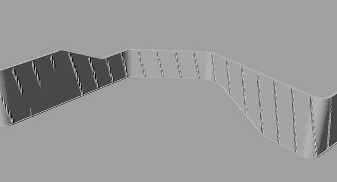

I have a GH definition from other people. It is long and looks complicated. I wonder what is the effective to understand this?
The rhino file is too large, I can’t post here. Hope this GH could demonstrate what I said.

Hi Tom:
Thanks for the understanding. Here I posted a rhino image. I am checking what kind of battery or method the original author used to populate the pattern into the surface. But CAN’T find one yet. If you could find, please let me know and thanks.
Sorry this forum is no place for doing your job for free. I can only guide you to figure it out for yourself. If you miss basic knowledge about Grasshopper you should learn it first.
It is OK and thank you for your help. I am working hard to find a solution by myself as well.
