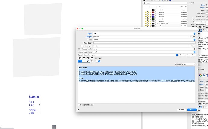

I’m trying to sum the values from a User Text attribute across multiple objects — for example, to get the total of the “Area” values.

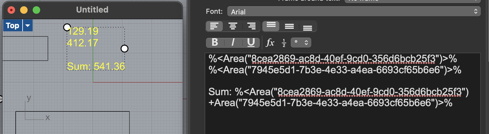

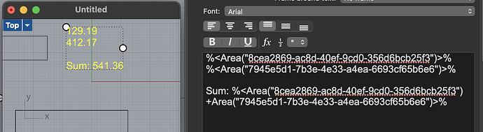

Hi Pip -
Sum: %<Area(“GUID”) +Area(“GUID”)>%

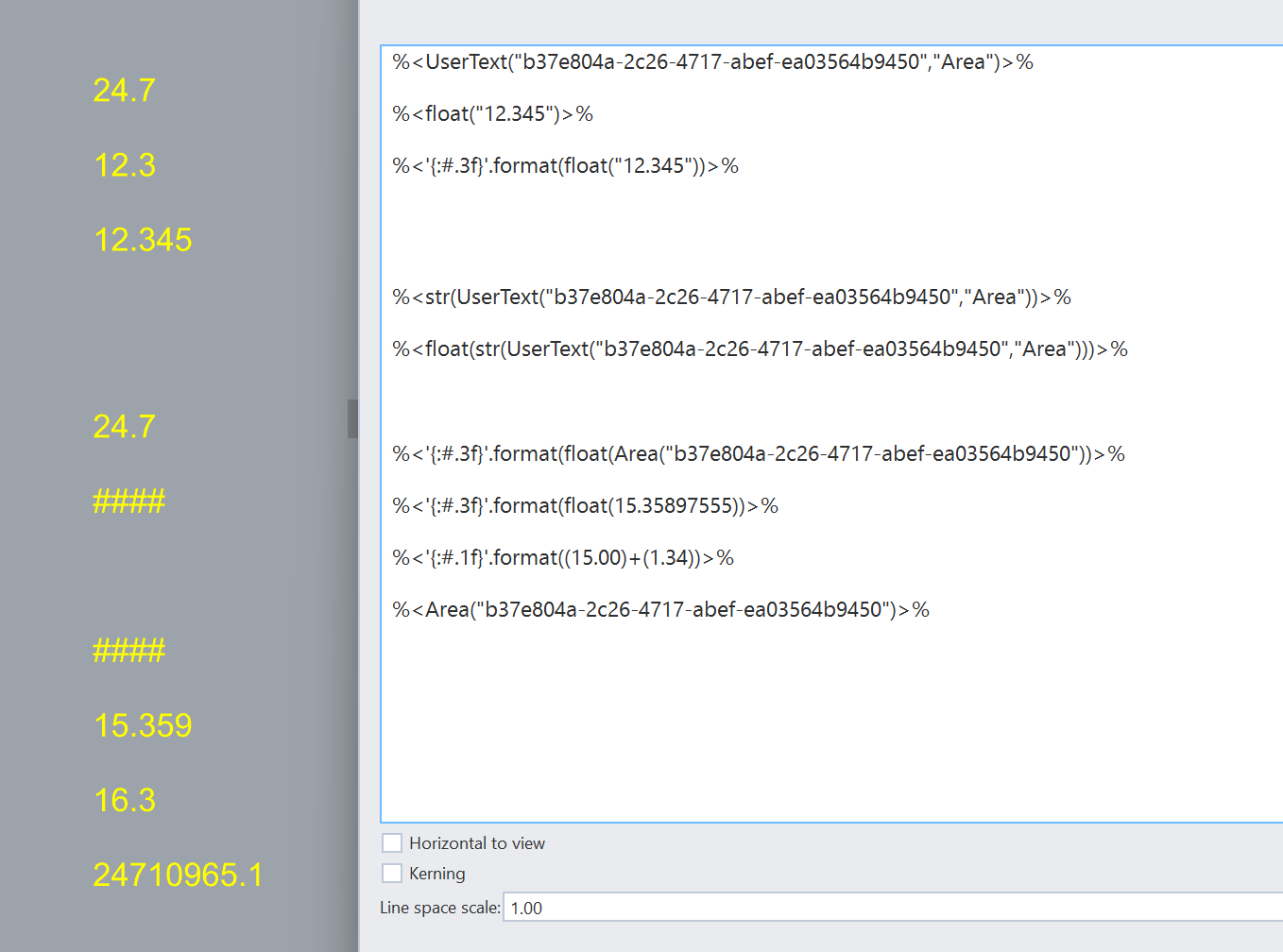

As Martin understood, I was more interested in executing operations on UserText directly rather than calling functions.
But It seems that applying an operation to a function like Area via UserText doesn’t work.
As Wim suggested, the function needs to be called directly.
For other types of UserText, however, Martin’s approach seems to work!
@wim what’s keeping the addition of attribute user text from working?

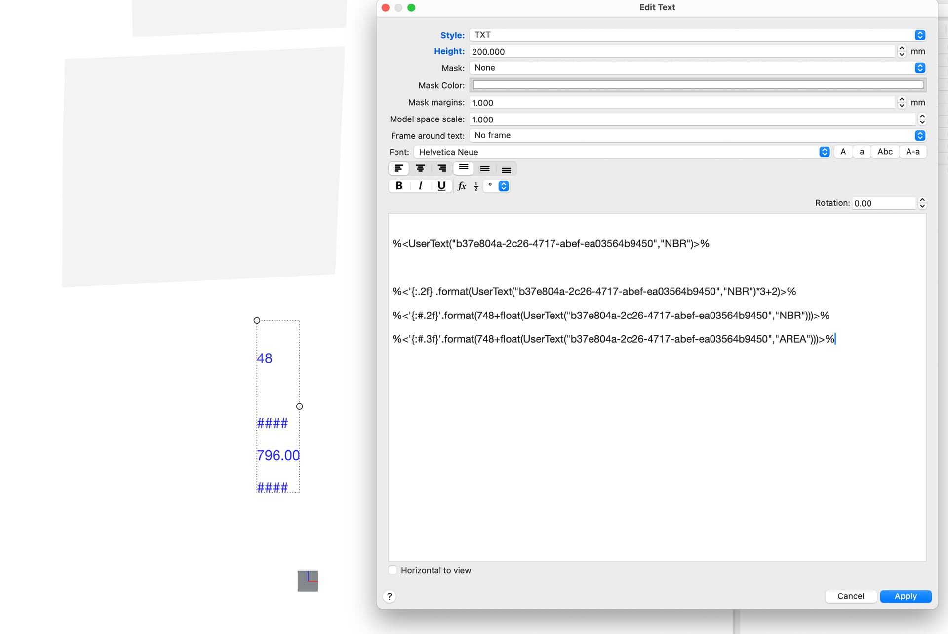

I tried a few things. Addition of numbers works but I guess the attribute user text isn’t parsed correctly. What’s wrong with this:
%<float(str(UserText("b37e804a-2c26-4717-abef-ea03564b9450","Area")))>%
