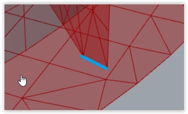

How can I stitch the mesh at non manifold edges (along blue lines below)?
I’m a rookie GH user, so sorry for my easy question.

What’s the reason you want to join the meshes without thickness?
If this needs to be joined into a mesh with non-manifold edges, you could split the input surfaces before creating the meshes. I baked and split the surfaces in Rhino and internalized the geometry again.

But the result (cyan Edge is connected to more than 2 Faces) MAY could yield bananas when attempting to extract Connectivity data.
More or less the same approach for the rest of " bracket" Edges.
That said that sort of modelling via Meshes is 100% wrong.

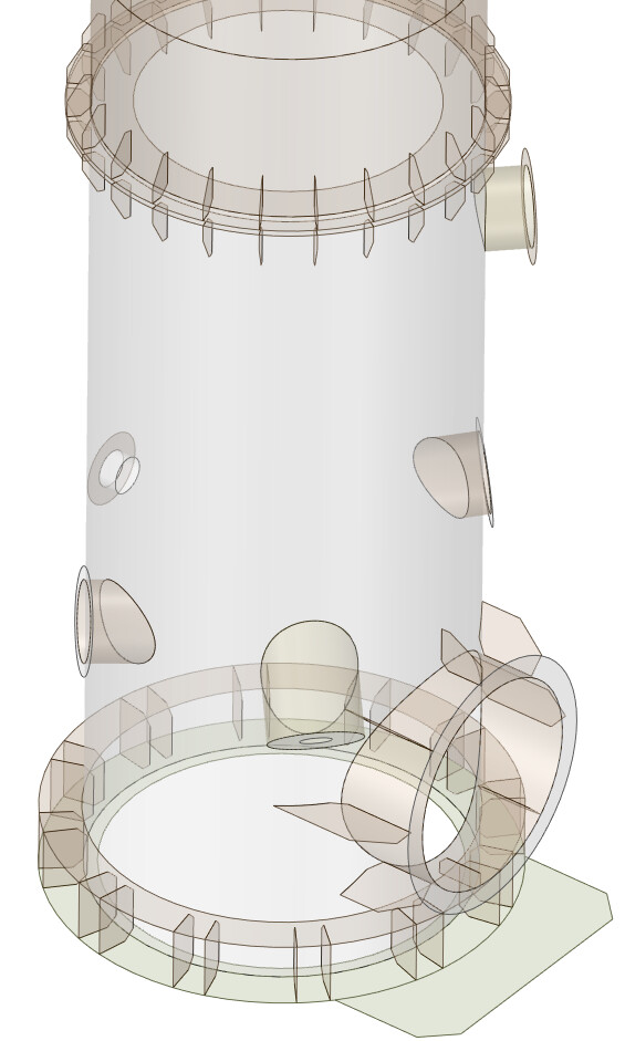

I’m a steel structural engineer and I would like to analyse a 16m high steel chimney containing 7 segments. In general, one segment consists of one cylinder, two flanges on both ends and some stiffeners around the perimeter (as you could see in the attached file).

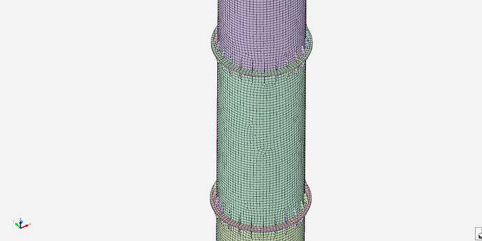

Generally, we pre-process (clean, repair etc) the solid STP geometry of the chimney in ANSYS SpaceClaim software and convert it to shell geometry. After that we mesh the model in ANSYS AIM to make Finite Element Analysis. See the resulting mesh below in this case. As you can see the mesh is joined at the common edges: 1) at cylinder -to- flange connection 2) at stiffener -to- flange connection 3) at stiffener -to- cylinder connection. We achive this topology by “imprintig” (projecting) the edges to the surfaces, and switch the mesh settings to “Shared Topology”.
Imprinted edges in ANSYS SpaceClaim (some stiffeners are hidden):
Now, I need to analyse the chimney in another FEA software, which is not as sophisticated as ANSYS (for shell calculations), thus I need to generate the mesh in another software (Rhino/Grasshopper). After that I export this mesh, and import it to the FEA software, and define shells with a given thickness for the mesh elements (quads/triangles).
So the goal is to achieve the above presented mesh in Rhino/Grasshoppers.
