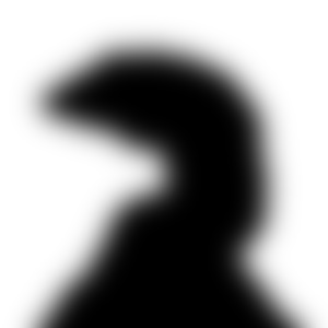

How to smooth this
@hifred
ZSurf4 works with 32 bit images…
Sorry, I meant something else here. Ordinary image displayed on a computer have 3 colour channels + possibly an Alpha Channel. All four of these channels have 8 bit, meaning 256 levels of colour and in the case of the alpha channel 256 tones of grey. Together that’s 32 bit.
What I mean is 16bit per individual channel. Images with higher bit depth can store more colours and in the case of displacement maps a lot more tones of grey. Smoother gradients result in smoother displacement – given the input mesh is dense enough.
Zsurf is a simple utilitly which has been written at a time, when even Photoshop couldn’t handle high bit depths. It’s a safe bet that it can’t handle higher bitdepths than 8.
:o)
I have made the image in Photoshop and I have kept him in the tif format (qualitative).
Без имени-1

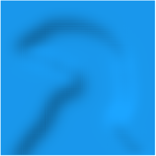

I use Heightfield, it is important to specify in Number of sample points size of the image. Result not very much:
And now it is necessary to use FitSrf with some accuracy and result already good:
But to excellent result - we apply Rebuild :smiley:
However, why in general artifacts appear?

I don’t know what that texture is. It doesn’t look like the banding you get from 8 bit. Might be some sort of dithereing.

the best solution without having to fitsrf too much and too rebuild i would suggest to keep the resolution of the image high in relation to the heightfield, so the jpg you showed on top is of course too small. after importing it into photoshop resizing it and using gaussian blur in 32 bit then reducing it back to 16 to import it into rhino, the image becomes instantly smooth with the best result using interpolate surface through samples. here both images have 80 x 80 points the left is the low resolution image on the right the high resolution.
of course if you turn up the number of points during the heighfield command it will try to get closer to the limitations of the image and will create a though finer but still rough surface. here 800 x 800
I would create a very high resolution height map instead of the low resolution you used. (I think the small dimples look like the separate pixels.) There probably will be still some artifacts, but the sampling will be more accurate.

i described 800 x 800 points not pixel for a rough but precise surface, just in case that was not clear. all the numbers i described where points. take a high resolution image (i took 1400 x 1400 pixel at 125 x 125 mm for the heightfield) and decrease the amount of points in the heightfield command try 80 x 80 points for the surface just to see the difference. the result is a smooth surface.
If you are using the jpg format, the texture you are getting is due to the jpg compression scheme
To avoid the texture use an uncompressed omage format
it makes a bit of a difference but its hardly relevant by the time you have reached a generally acceptable surface. in both cases below using 800 x 800 sample points an unwanted texture is being created. left the extra jpg artefacts, right the same image with a none compressed 16 bit PNG image.
below the same comparison with 80 x 80 points, left the jpg and on the the right the png the difference is already marginal.
i suggest to take an image which has a high resolution and lower the points till its smooth as you want.

I use the image 1200x1200, manipulations with a depth of color, preservation in TIFF, I specify the size 80x80 in Rhino. Result all the same with defects: :frowning_face:
looks better already now just raise the resolution further to 1400 x 1400 or more if needed
and you are probably there.
I dunno - it seems to me with a smooth image and control point heightfield, setting the points to match the pixels ought not to show artifacts like the lines in Modeler’s images above. So far I do not see anything in the pixels of the image that would account for the lines through the middle of the result-
At the image 2000x2000 - it is it seems normal…

Have you tried the edit → rebuild command to get more control points into the flat plane?
I did not see that in the prior post thread. I have better luck with displacement when I re-build – and add LOTS of extra U and V’s.
I tried to replicate issue and i found that png don’t work with heightfield but i used 16bit tiff - while playing with displacements and similar things 16bit workflow is crucial cause of amount of stored data. Small bak and forth with render mesh and looks pretty nice i think
