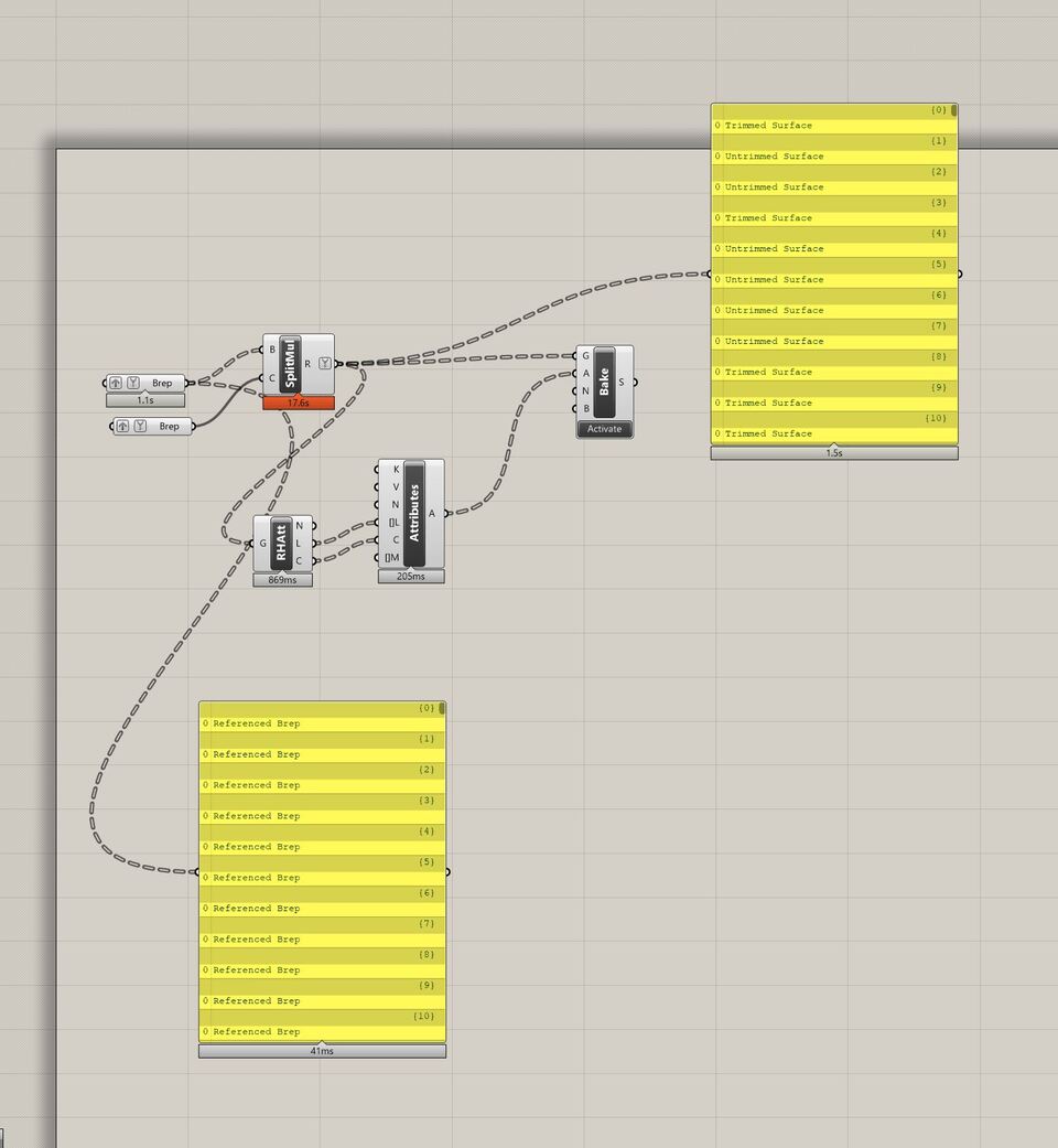

Hello! Just wondering if you found a solution/could explain to me how to solve this issue. I’m not sure how to retrieve the layer attributes after carrying out the split multiple component! Thank you.
Hi. The layer info can only be obtained before splitting. after you carried out the multiple split, your Surfaces will stay in the same ‘tree’ as where they came from. (use component ‘panel’ to see what happens after each compononent). for example input is ‘untrimmed surface’, output is ‘trimmed surface;trimmed surface; trimmed surface’
because the trimmed Surfaces are still in the same tree, you can combine the list with layer info with the list of trimmed Surfaces. (use components like ‘entwine’, ‘merge’, ‘cull pattern’, etc.)
I don’t know if this makes any sense. To help more specific, could you share your problem? (or a simplified version of it)
Hello! Thank you for your response! I am fairly new to grasshopper so still learning.
This is what it’s looking like at the moment. Do you mean I combine info from the breps with the trimmed surfaces after split multiple?
if i’m not mistaken, you just showed the solution. right?
what is it you want to achieve? you want to ‘bake’ the splitted breps and put them in the layer they came from?
is this what you’re looking for? I moved the splitted breps up to show that the baked output is on the same layer.
Hello! The entwine command helped! Thanks so much. Saved me hours!
