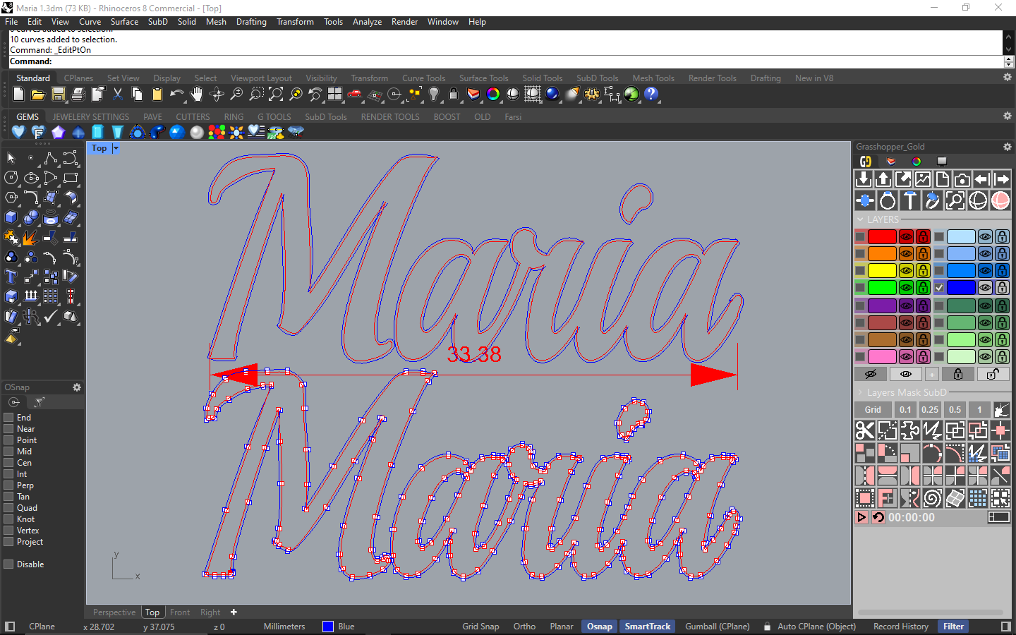

How to offset curve with Loose Yes but with trim the intersect on Rhino6
i attached pictures. there is on Rhino 7 Command-line options: Trim (Yes/No) Specifies whether the intersected curve segments will be trimmed to the corners… but I have Rhino 6. and i use Curve Boolean to trim . but it takes a long time.
Hello- you can get this ‘loose-ish’ behavior but making the tolerance setting at the command line in Offset larger.
Thanks Pascal i make tolerance 100 ( it was 0.001) but the number of the points is difference. i want the same points number. picture attache d and rhino file attached Raghda.3dm
another example on picture 2 ( the letter m on Red main Curve have 2 points but the offset curve have 5)

use Offset Loose = yes , and then trim overlapping parts, and for the parts that don’t connect, use Extend with ExtendOtherCurvesBy=Smooth
Thanks Gijs de Zwart. but it takes a long time.
FYI: RH-81146 is fixed in the latest WIP so it may help with this issue. Please give it a try.
