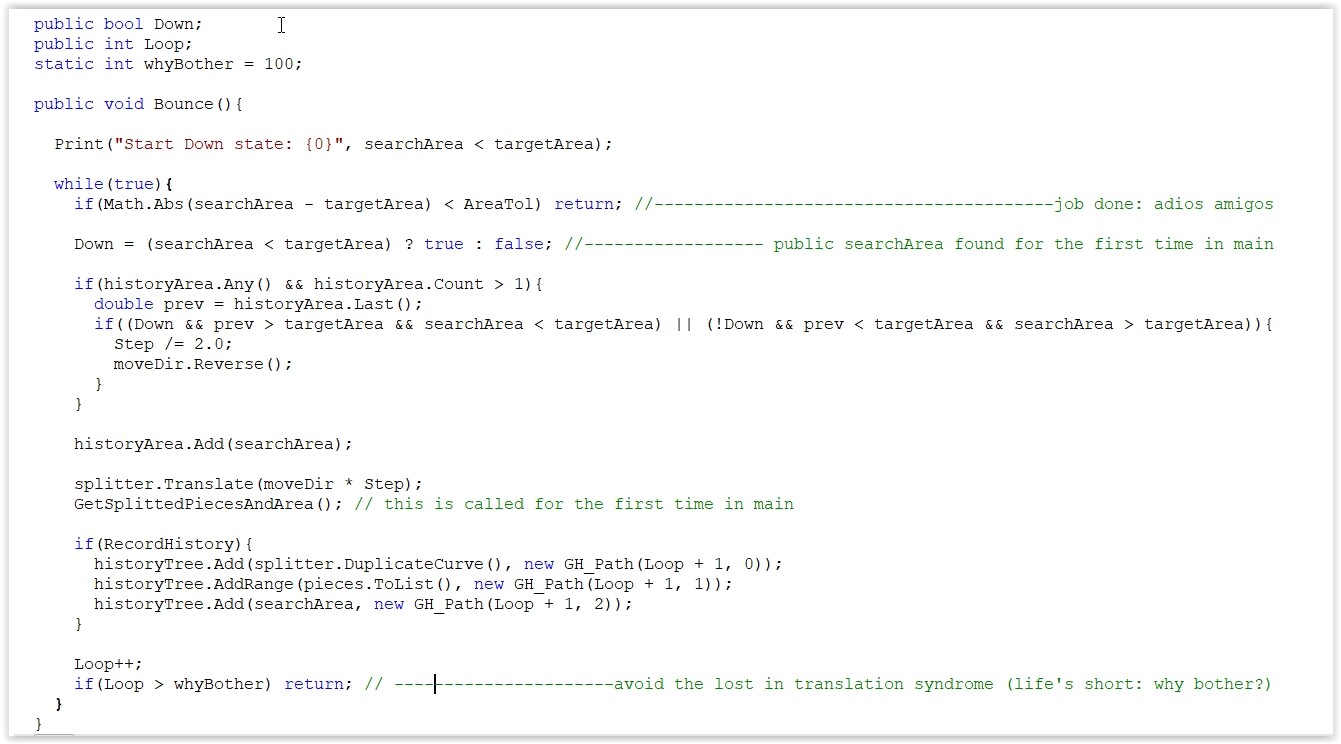

Given the opportunity what we use in similar problems is a bounce solver approach. For a given target value we start from some “estimated” value (that is extracted - at each later attempt - explicitly via some Method [like Ccx Brep/Mesh/Plane for your case]) and we set a grow/srink state using some start step value . If state is grow (meaning value+= step) and Math.Abs (target - value) > someTolerance and value > target then state is set to srink and step is divited by 2.0 (value -= step) … etc etc. So for each attempt the found value “bounces” around the target value (while the diff/delta becomes smaller and smaller) until the diff/delta is less than the desired tolerance.
Notify if you want an entry level demo C# (but could be 100% useless if you want to address that issue via components).

BTW: Better start from some elementary bounce solver task: given Curves that define a BrepFace (the black) and a random pos Splitter (the blue) … find a Splitter pos that yields pieces (the light blue) where their Area Sum is a given value (within soma rational tolerance). All that IF there’s a possible solution around.
Try to “mimic” (hope dies last) this sort of logic:
