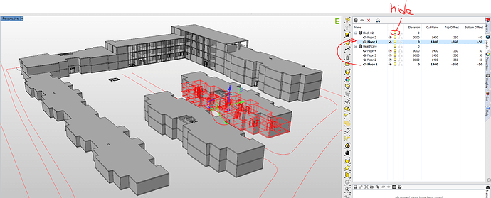

Hello forum,
I’m still learning VA, so please sorry if the question is rather silly.
I was creating all of my geometry inside of one Building (“Health care”). Now when I’m almost done I tried to reorganise some of the buildings to another Buildings to fully hide them and get rid of the lag on my laptop. I can’t find a way to put geometry from one level of one building to the same level of another building. If I understood the concept of levels correctly this is a great way to neatly organise geometry in each building.

Hi Tim,
The “buildings” in the VisualARQ Level Manager are used to organize levels at different elevations, so these levels have a construction plane at their elevation and a Cut Plane that is used to show them in Plan Views. But these buildings don’t have a specific boundary area to define their limits in plan views and goemetry is not attached to them or to the levels. We may consider these features in future versions though.
The on/off button next to the building icon is used to unhide at once all the levels in that building.
Thank you for all your suggestions. I take note of all of them and hopefully we can work on them soon. The buildings are listed in the Level Manager alphabethically, so you can control their order by changing their names.

Since objects are not still attached to levels or buildings up to the 1.9 version, if you want to move them from one level of a building to another level of a different building (or even the same building), you just need to move them “manually” to the corresponding elevation of the level. If that level has the same elevation as the original level, you don’t really need to move the objects.
