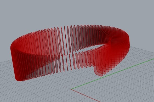

I have a practice is to make a shape like this pics.
1654932287646
But I always can’t make the fist one connect with the final one in a smooth way.
I want to make this is more smooth with the blue line.
Is there have any way to fix the problem?
Can anyone helps me for this, Thanks :sob:
20220611_Prcatice.gh (14.6 KB)
this is one way to do it, cut your series in half and reverse the list and merge the two together
20220611_Practice2.gh (12.4 KB)
Thanks, Gijs.
But here the connect place will looks sharp.
Is possible to make it more like wave?
Then not use the graph mapper but use a sin or cos function for that, then you get fluent waves:
20220611_Practice3.gh (12.2 KB)
This way is pretty good, thanks a lot. :smiley:
