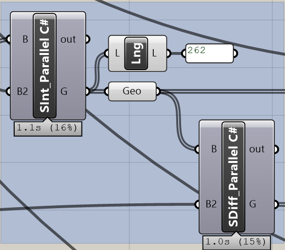

OK, good morning. Here’s a version with all the optimizations suggested by @qythium PLUS two new script components called SDiff_Parallel and SInt_Parallel (C# scripts). The results are from Rhino6. Difference in speed:

SDiff = From 7.6 to 1.5 sec (1.0s for R5, see far below):
SInt = From 4.9 sec to 1.2

@DavidRutten: For some reason the RhinoCommon SInt script call doesn’t give the same result as the GH SInt component (There’s one or two missing plates when using my SInt component)

It might be an off-by-one error somewhere in your code - I didn’t try looking at it too closely but here’s a quick one-liner using PLINQ that does essentially the same thing, a little faster :grimacing::
G = B.AsParallel().SelectMany(b => Brep.CreateBooleanIntersection(b, B2, 0.0001) ?? new Brep[0]);
sandman - Copia - RE3.gh (28.3 KB)
Running on Mac Rhino 5, but also getting different results with the native SInt component.
I also tried setting the tolerance to RhinoDoc.ActiveDoc.ModelAbsoluteTolerance but that didn’t affect the result counts.
Yes, removing “- 1” gives 262 :
sandman - Copia - RE4.gh (28.5 KB)
Still one missing up to 263 though…
