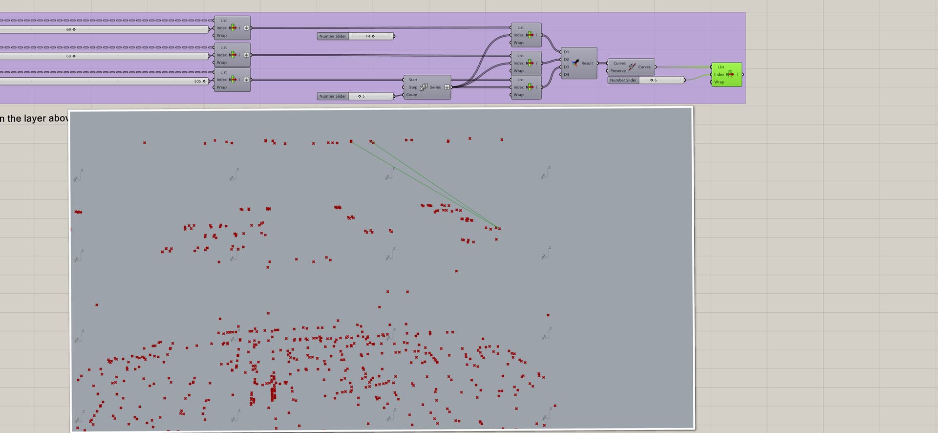

Hi everyone,
I’m trying to connect all of the points from the first layer of my collection of points to the second, third, and fourth layer. Something like the green line in this image.
 ![Screenshot 2022-10-14 213345](https://global.discourse-cdn.com/mcneel/uploads/default/original/4X/c/4/e/c4ea39c97cbd5c285420e8fb6b7ec212e2595fde.png)
My goal is that I would have a line going through a point in each of the four layers. No line is the same, but multiple lines can go through the same point. The minimum and maximum number of vertices that the line must go through is 4: one for each layer I have.
I hope my issue is clear to understand.
Thank you for your time!
[How to make a line across layers of points at different heights.gh](https://discourse.mcneel.com/uploads/short-url/od24UdUG2k5bbKNJE43DA6K1otH.gh) (129.5 KB)

Well … assume that you have nl number of “layers” (i.e. Points **GroupedBy** their **Z ± delta** value). Assume that each layer has Nx pts … then the lines are:
N0 \* N1 \* … \* N(nl-1). This could be a very big number of Lines yielding a **chaotic** Graph. For instance for 200, 300, 400, 500 pts in 4 “layers” you’ll make 12 **B** lines (4 nested Loops).
Or there’s some addicional rules around? For instance: **proximity rules,** min/max slope per segment, prev-next segment min/max angle, **valence per layer Pt** (that makes some sense), average Line Length, segment min/max Length etc etc.

this is a pretty random solution 🙂 it just connects random points from each layer
it does not guarantee that all the points are vertex of a polyline, but it tells you how many point you’re using for each layer
if you’re not happy of a given result → go next seed, and if you’re looking for more connections just increase the number of polyline (and prey god 🙂 )
 ![image](https://global.discourse-cdn.com/mcneel/uploads/default/original/4X/c/2/f/c2f3937307816ee96139ad90aa9e1af7f3f0671d.png)
[How to make a line across layers of points at different heights\_Re.gh](https://discourse.mcneel.com/uploads/short-url/oR8YCnaeBWt9qTNyjaMBsQeOB4l.gh) (39.8 KB)

I’m looking for precisely that - a chaotic graph. My end result would look something like this.
 ![Screenshot 2022-10-15 105117](https://global.discourse-cdn.com/mcneel/uploads/default/original/4X/4/b/c/4bcf7c52144463bef34ab568155fbcb70824d989.jpeg)
My problem is that I want to connect each of the white lines to each of the blue lines to each of the green lines. Something like this image but for all of the points in each layer.
 ![Screenshot 2022-10-15 110710](https://global.discourse-cdn.com/mcneel/uploads/default/original/4X/a/9/9/a995aec846101d2e544a8a4c4ca8abc634e712f0.png)
However, when I used the `join curves` command, my Rhino would crash. If I extract a subset of each of those lines and then run `join curves`, it would join random instances of curves, oftentimes making a V-shape like this image, which is not what I’m looking for.
 ![Canvas at 11;00;34](https://global.discourse-cdn.com/mcneel/uploads/default/original/4X/e/c/1/ec10447aa0990e64009f1e5914c491066f9fb847.jpeg)

> [@Jacobian](#):
> chaotic graph.
Good news: Is easy to do Chaos without a (used) Cray: i.e. less is more.
Bad/Ugly news: The attached is 100% C# code.
[Points\_CombineGroupsInZ\_V1.gh](https://discourse.mcneel.com/uploads/short-url/s1usfUgrdUNR7N5pWsmP6i2ZnKY.gh) (121.3 KB)
 ![Screen Shot 078](https://global.discourse-cdn.com/mcneel/uploads/default/original/4X/8/5/5/85539a3fca059bfd3d5176ea56b3cfb38894795e.jpeg)
How it works:
1. The first ( **existed** stuff written for other purposes) does random points without a “uniform” distribution (like David’s thing) meaning that their creation is real-time fast. Then it finds Clusters of points where their Z is within a given Interval (± **delta** ). Clusters are sampled in a DataTree (and Pts indices in another). Plus a List (ZIDX) is made with the path indices ordered by the pt Z coord. This ZIDX thingy is a must to have on hand (since everything is random … etc etc) when we do the connections in step 2 .
Of course for these rnd points one could use various LOL ways: like clouds “around” random spots … or in some push/pull mode using attractors , blah, blah.
1. The second (just a couple of lines - no big deal) does the connections and - most importantly the **VV connectivity** - with 2 modes ( **combine == true** means all to all - per pair of Clusters). That said a Graph without VV connectivity is kinda a man without a Ducati.
Notice that there’s Chaos (with some sort of rational manner) without that Cray.
Noboby could bother to count the Clustered points (no big number in fact) while the … er … hmm … Graph Chaos is assured. Obviouly the N of “layers” is random … meaning good quality (LOL) Chaos, what else?
Moral: Chaos is the new Order.
