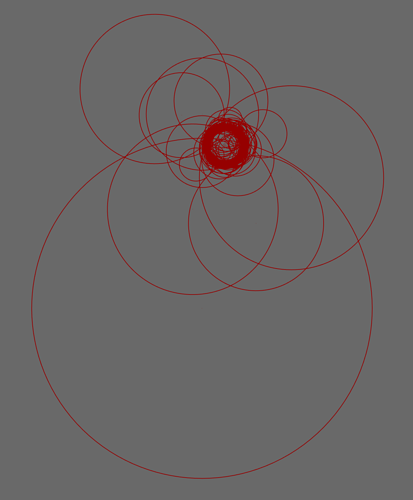

I was thinking of a method to someway evaluate if any point is on an arc together with its next and last points and somehow create a list of points which are the most common on arcs which shares the same radius… and then it could really get the “common points”… Does it make any sense?
If the points are not derived from actual circles and do not have a clear center point, some sort of rounding is required. I wouldn’t create circles from three consecutive points shuffle the list and create lists with three points each.

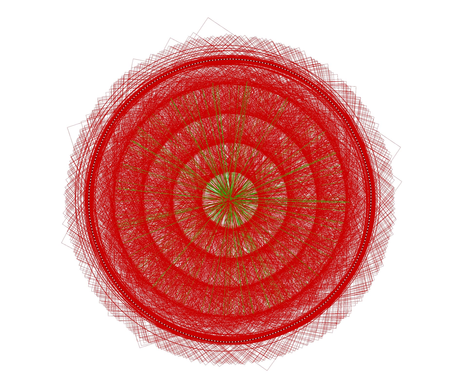

You are right, one approach is rounding the circle but as your solution is great, it still takes all points into consideration. I was wondering if I could get it to be even more accurate by ignoring the points which are not the common points of the circle that could virtually fit through most points.
So I was also trying two other things, assuming the points are derived from a curve which is almost a real circle, I even had it rebuilt with Degree 3 to smooth it out and was trying to compare consecutive arcs (more like all arcs from any 3 points) which didn’t produce a common radius as you can see.
I’ve also tried to make the arcs larger, spanning 5 points for example but still didn’t get a common value.
and also tried to rebuild the curve to Degree 3 to smooth it out a bit and rebuilt again to Degree 1 to convert it to straight lines and then tried to compare the angle between any two consecutive lines.
Still no common value appeared… but a wide range.
I was thinking this direction should make sense but I guess I’m still missing something.
