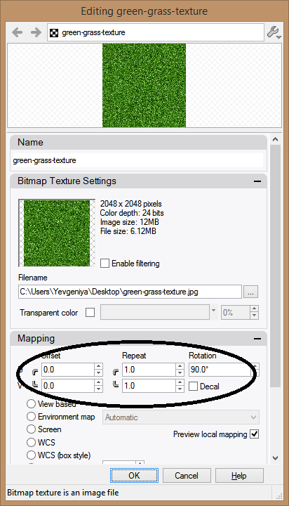

How to get textures settings from code?
How to get settings of texture?
@andy is this something you can help with? Jane is using C#…
@Zombik,
i am not quite sure if this is the right way to do it but below seems to work using RhinoCommon via Python. It lists materials with assigned bitmap-texture then prints the repeat, offset and rotation vectors. Note that if you use 3d textures there may be more values to print:

i guess instead of using scriptcontext via python scripting like this:
scriptcontext.doc.RenderMaterials
you might have to access the render material table using the Item index to get a single material in C#. From there you might get the texture slot etc. as shown above. I´ve found the render texture methods here.
