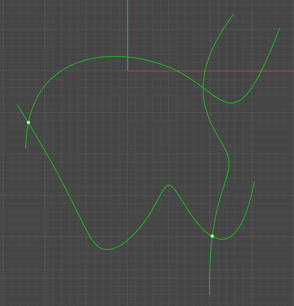

I want to get rid of this part:
for event in insect_event_01:
    tmp_pt_lst.append(Rhino.Geometry.Point3d(event.PointA))
but insect_event_01[0].PointA
doesn’t work

The problem appears when the order of selection has a possibility to create a couple of curves that do not intersect.
My algorithm works flawless if there are 2 and 3 curves.
If you add more, in my case it’s 7, it breaks:
You need to order the curves or select them in orderly manner, that’s why I created the other thread about ordering the curves. I’m now trying to make both algorithms work together.
Yes, but that’s a separate issue. I simply answered the part that insect_event_01[0].PointA does work if the intersection actually exists. As far as ordering the curves goes, well, good luck…
Here is the sample i promised @ivelin.peychev:
import Rhino
import scriptcontext as sc
def splitCurvesWithEachOther():
    # get tolerance from doc
    dTol = sc.doc.ModelAbsoluteTolerance
    # get curves
    result, arrObjRefs = Rhino.Input.RhinoGet.GetMultipleObjects("Pick curves", False, Rhino.DocObjects.ObjectType.Curve)
    if result != Rhino.Commands.Result.Success:
        return result
    # convert from objRef to Curve
    arrCurves = [obj.Geometry() for obj in arrObjRefs]
    # empty list for split parts
    listCurveSplitParts = []
    # iterate over all curves
    for i in range(len(arrCurves)):
        # empty list for intersection parameters on test curve
        arrDIntersectionParams = []
        # iterate over all curves again
        for j in range(len(arrCurves)):
            # intersecting a curve with itself only leads to cunfusion...
            if i == j: continue
            # do the intersection
            arrXEvents = Rhino.Geometry.Intersect.Intersection.CurveCurve(arrCurves[i], arrCurves[j], dTol, 0.0)
            # in your case, Ivelyn the curves only ever intersect their neighbour once
            if arrXEvents.Count != 1: continue
            # we got here so we can append to the intersection parameters
            arrDIntersectionParams.append(arrXEvents[0].ParameterA)
        # tets if we really found 2 parameters
        if len(arrDIntersectionParams) == 2:
            # do the splitting
            arrCurveSplit = arrCurves[i].Split(arrDIntersectionParams)
            # should be 3 parts
            if arrCurveSplit.Count == 3:
                # keep the part in the middle
                listCurveSplitParts.append(arrCurveSplit[1])
    # join it all up
    arrCurveJoined = Rhino.Geometry.Curve.JoinCurves(listCurveSplitParts, dTol)
    # test if it worked :)
    if arrCurveJoined:
        # finally add to doc
        sc.doc.Objects.AddCurve(arrCurveJoined[0])
        # and redraw for visual pleasure
        objAdded = sc.doc.Objects.MostRecentObject()
        objAdded.Select(True)
        objAdded.CommitChanges()
        sc.doc.Views.Redraw()
if __name__ == "__main__":
Let me know if this helped :slight_smile:
PS: No need to order things, just box select away
