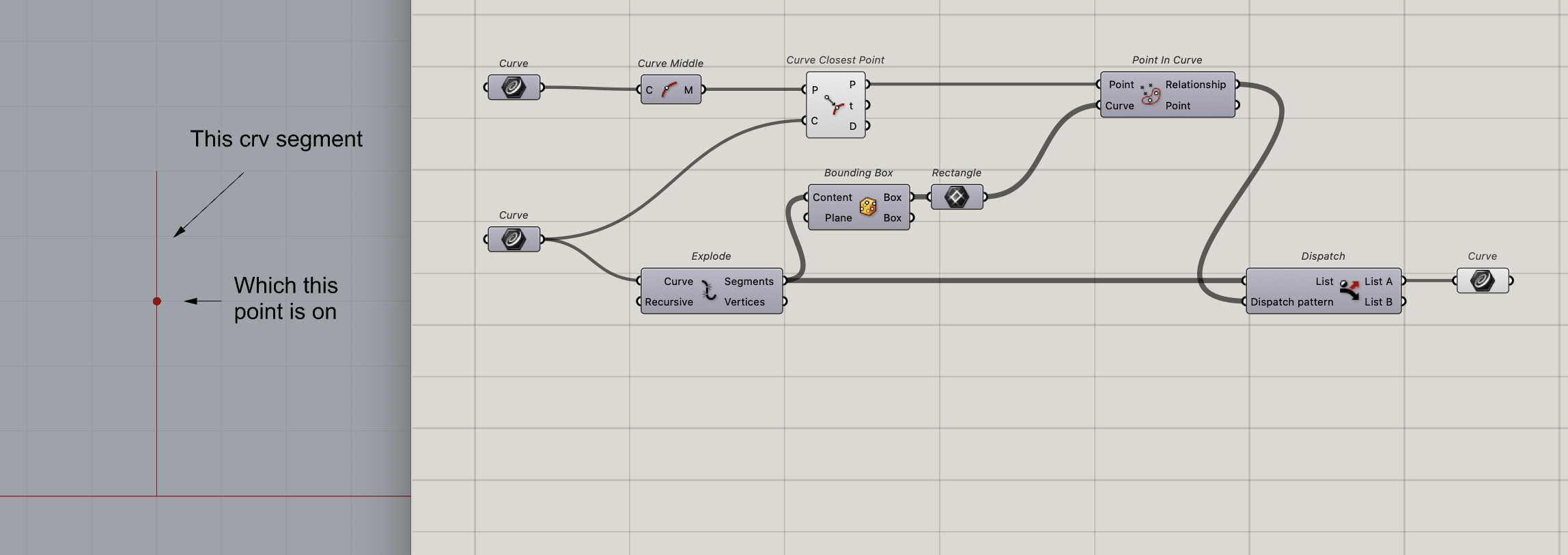

Hello friends,
I’m trying to get the curve segment which a point is on:
Get the segment point is on.3dm (131.1 KB)
Get the segment point is on.gh (4.2 KB)
I couldn’t find a component that outputs a curve or a list of curves and a value that indicates if the point is on it like “Point in curve” does, “Point in curve” could tell me the point is on the curve but not on which segment it is on…
Many Thanks in advance :slight_smile:
Roy.
Possible solution
Get the segment point is on jk.gh (7.3 KB)
Fennec addon have a component Points on Curves.
Use graft to get a tree of points following the list of curves.
pt on crv.gh (13.7 KB)
Thank you very much,
I’ve tried a similar solution with “offset curve” instead of the “0 width” rectangle you made, but from some reason while using corner type “Sharp” the offset didn’t produce a closed result.
Thank you very much as well and for your plugin as well, I might use it if I’ll need to get a more advanced solution than the one above :pray:
Here a solution that doesn’t need offsetting or linear boxes:
Great, Thanks… That’s even better :slight_smile:
I ended up using @anon39580149 solution as I needed multiple points on fewer curves.
Thank you both! :pray:
