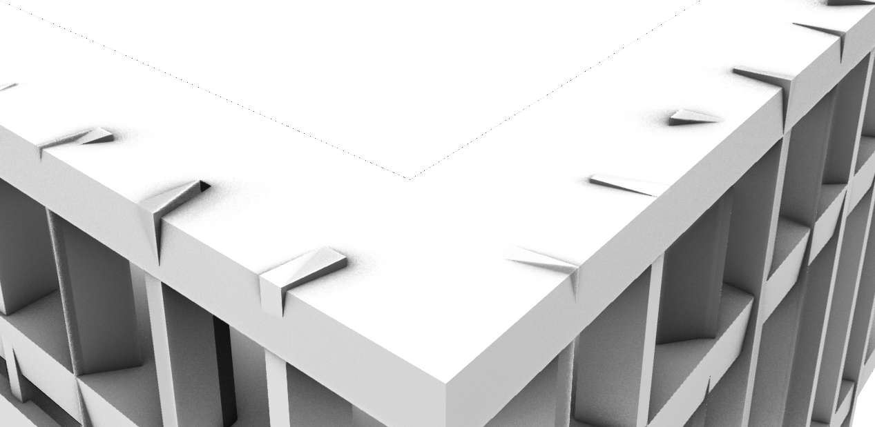

My perspective view detail showing in bad quality and error detail
How to fix it .thanks

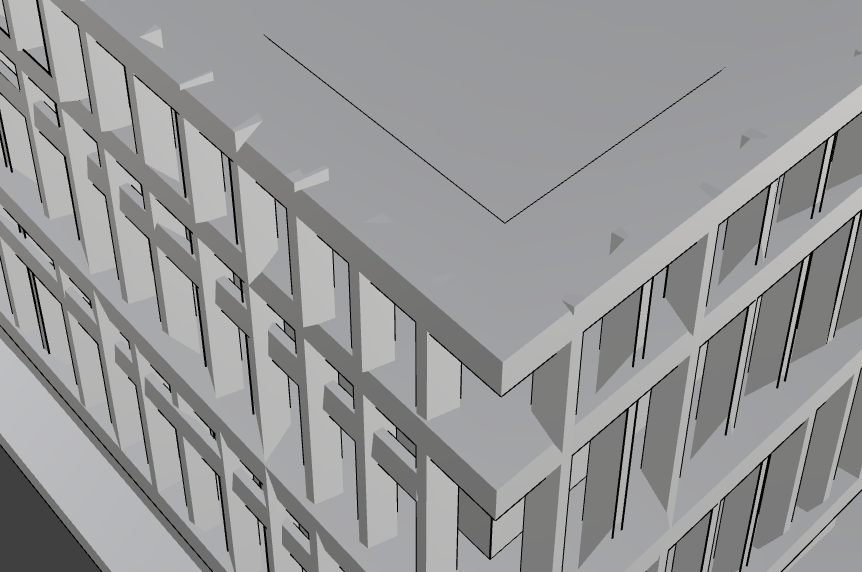

This is my actually model detail

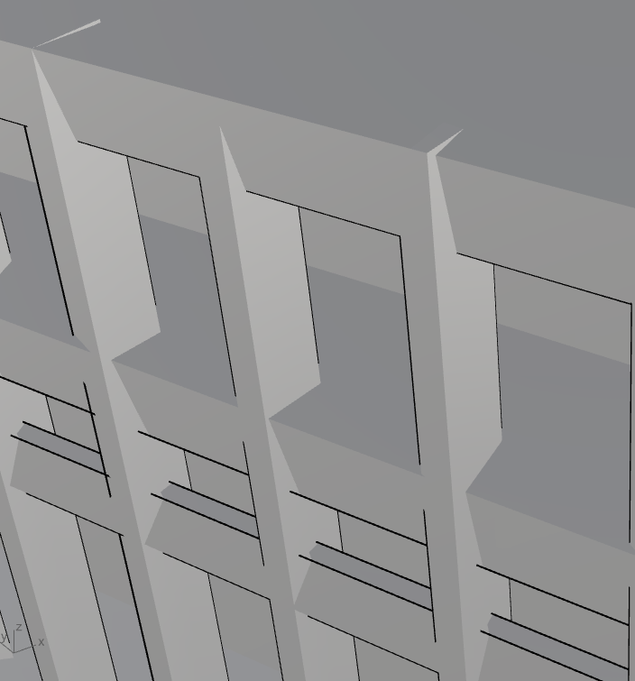

You can run the commands below:
_Selbadobjects
_check
Edge analysis tool
It is always crucial to include clean modeling practices in your designs so you can avoid most of the issues.
Also, make sure you’re not too far from world origin.
Please check File → Properties → Mesh → Smooth and Slower is selected…
Wow! My model was actually too far from origin point when i moved it to the origin it was fixed thanks a lot Nathan.
Thanks a lot ,Tay.
Thank you.
