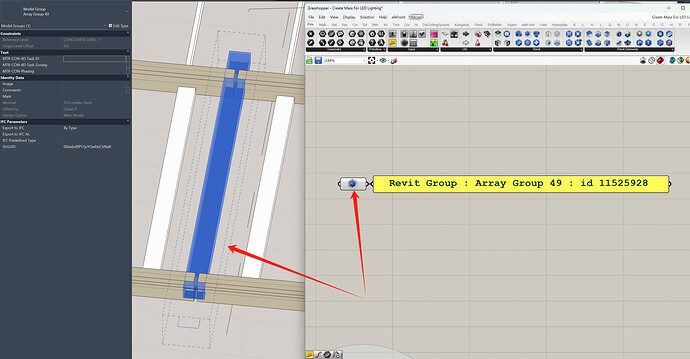

How to extract elements in a group?
Hi all, Is there a way to extract elements within a group without ungroup them within Revit?
You can use GetMemberids method from the Group Class and then use the Query Element Component to get the Elements

Cool, thanks Muhammad!
@Jack_Zeng there is a native component Group members you can use that one.
I just saw it :slight_smile:
