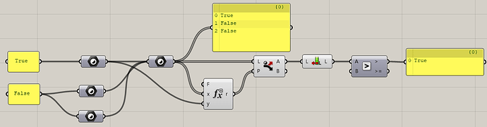

From your suggestion I made blocks this way.
this might works.
At first , I want to replace True to 1, False to 0 and calculate, but I don’t know how to replace ・・・
So I made this way.

I want item(True or False) from list ,so your suggestion to use mass addition is the best way!!
I thought another 2 ways. Later one is also good.
I learned many things from this question. Thaks!

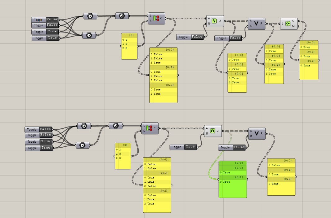

TrueFalse.gh (18.6 KB)

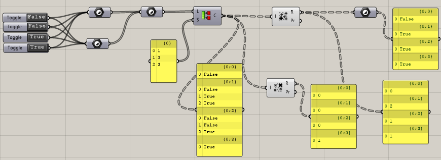

When there are two true, this logic have trouble
So I Changed like this.
TrueFalse.gh (21.5 KB)
I’m not following your experiments in detail but it appears to me that you don’t understand the effects of Partition and Create Set.
I’ll leave you with this, showing how Mass Multiplication of Booleans is equivalent to logical AND, just as Mass Addition of Booleans is equivalent to logical OR.

I used Partition to express part real problem using tree.
Maybe you don’t need Partition, because you may understand difference between tree and list.
But I don’t know , I’m very beginner. My experience of GH is within 1 month.
So I used partition.
TrueFalse.gh (21.3 KB)
Do you have any suggestion to get these basic techniques information of GH?
I’ve already made them. Partition makes no sense to me at all in this context and may be contributing to your confusion…

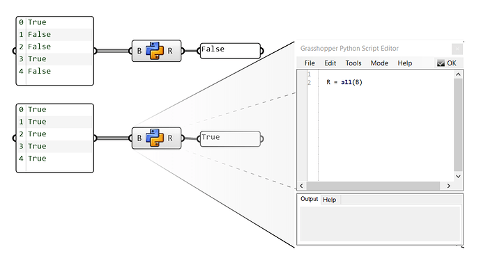

Just in case you aren’t aware, you can also use Python in Grasshopper:
210711_GHPython_All_00.gh (4.8 KB)
What a simple way!!
To tell the truth, I once tried using python but couldn’t do it.
I don’t know how to treat boolean.
A boolean is true (1) or false (0). That’s really all that is to it. :slight_smile:
I could understand From your sample.
Thank you so much!!

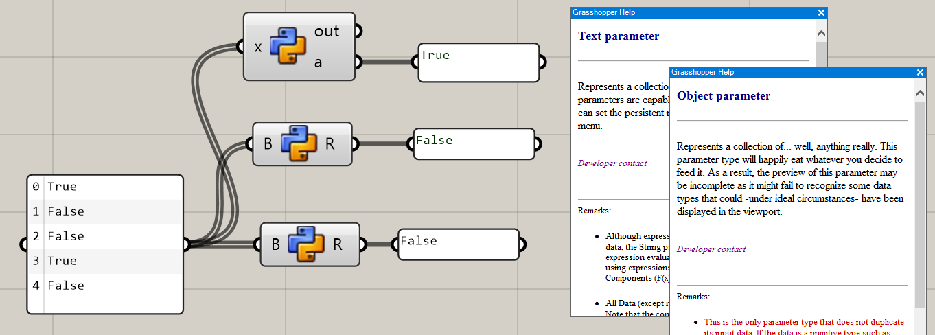

  1. text parameter and object parameter
  2. List Item
210711_GHPython_All_00.gh (8.0 KB)
It looks like you are demonstrating ‘List Access’ and ‘Type hint’ = ‘bool’ in Python?

At first ,I tried python script by using all, but it didn’t work.
Now I could understand why python didn’t work because I didn’t know list access and so on.
After python script failure , I also gave up by branches and write this thread.
I’m just searching Entwine. I found from your suggestion. Very good timing!!
The Python that @AndersDeleuran gave you works with branches too, equivalent to MM.
