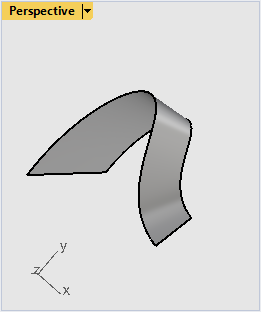

If you select multiple surfaces and opened polysurfaces, can you automatically convert the uniform normal direction?
Now I can only select the inverse object to perform the Flip command flipping it, if I can select all the objects to automatically switch to the same normal direction. This will be very quick.
Thanks
Hello -the script above will flip individual surfaces to match some known direction - in my example, the World Z direction, but if there is no direction to compare with, or if the surfaces are have inconsistent normals in 3d space at different locations on the surface - say on a half cylinder - then I do not see how to reliably set normal directions to what the user expects.
What is your suggestion?
Does this impossible?
Hello -
Well, my question is what is “this”? If this is making sure that some open planar objects that are not parallel to the test vector are facing either more with, or more away, compared to that direction, then yes, that is certainly possible. But as soon as you allow arbitrary shapes, I would say it becomes difficult to decide what direction you’re working with:
What can ‘uniform normal direction’ mean for a collection of surfaces like this?
