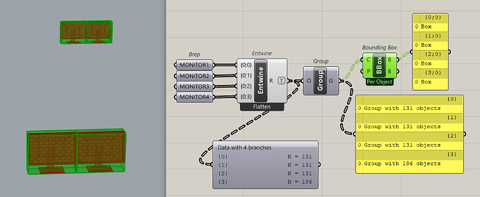

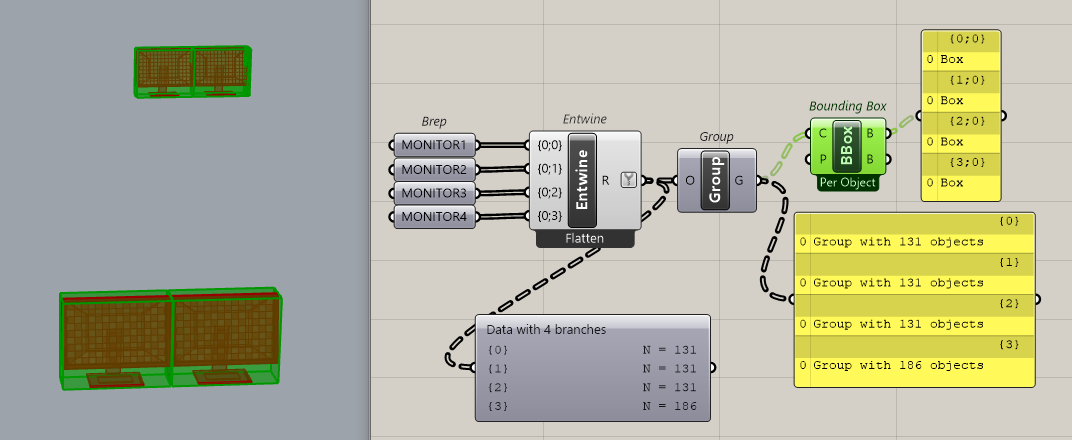

you can create a tree where each different monitor belongs to a different branch using Entwine
at that point if you want a single item per branch you can group them together:

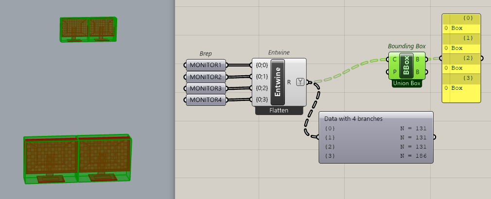

but I’d go for not grouping them, and just use the Union Box option from the Bounding Box component, in such a way all the geometries of each model can be accessed/filtered easily?
unnamed (12)_Re.gh (1.4 MB)

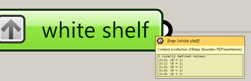

putting each object/item in a tree branch makes sense, however, besides the separated items like this, I also have a few other breps (each representing one item) saved in one component, how can I join the trees so I can have access to all items as a list of branches?

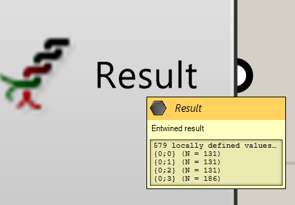

In summary, my second question is how to join this entwined tree with 4 branches:
to this tree with 5 branches(grafted):
to have a tree with 9 branches starting from path {0;0} to {0;8}?
