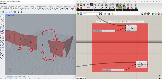

Hi everyone!
As u see on the photo, I need to customize my list item ; reordering from zero to … from the begining to the last surface . do u know how to manage that?
Boiler suit.gh (20.9 KB)
Sort your lists along X or Y.
Boiler suit.gh (21.3 KB)
Sort them by X: (white group)
Boiler suit_2023_Aug12a.gh (21.8 KB)
u’re amazing!
