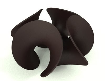

I googled, youtubed and searched in all previous threads in here but could only find an outdated script that created a weird Enneper. Any edits to the attached script or suggestions for a new one?
It looks like one of Eva Hild’s ceramic sculptures. She does some beautiful work - I think she works by hand, without a computer involved. The shapes do look something close to minimal surfaces but I doubt they are actually truly minimal.
You could generate something similar by relaxing a mesh with Kangaroo though.
You surely could replicate that using low poly (quad) mesh that are subdivided and then smoothed. It requires some modeling so it is not so parametric. Look at Subd modeling, Catmull&Clark smoothing … in Weavebird

Dear Corellaman, I found this one too but couldn’t replicate it because I couldn’t find the x,y,z components towards the end…
what are you talking about? there’s a .zip you can download in that page, which has the gh file in it, which should already have that component, which is just a ‘construct point’ component you can easily recreate in case it’s not in the file for whichever reason.

@laurent_delrieu That is a very helpful idea as well! thank uuu <3 @seghierkhaled I dont know how to use MathMod unfortunately… but thank you so much for the help! @DanielPiker I love her works! I thought she starts with computer modelling … looks like a generative design!! Thank you for the info!
