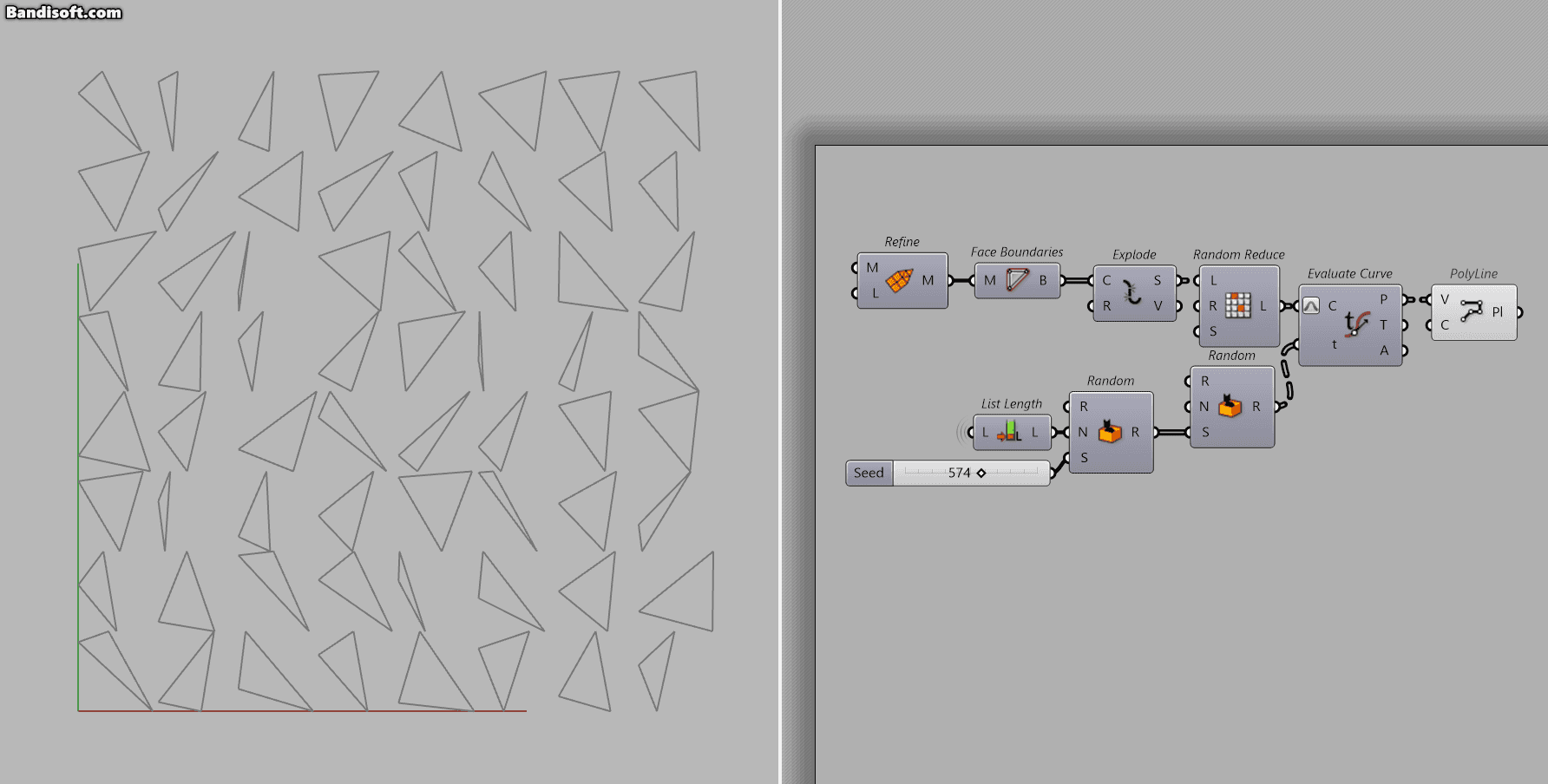

I am trying to make the 3 points of the triangle all touch the edges of the square. I have been trying to do so by working with the center point of the square, but by doing so, only one corner touches.
How do I make the largest triangle possible within the square?
random tries.gh (10.5 KB)
Honeycam 2023-08-11 13-40-54

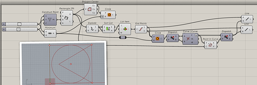

Thanks! Is there a way to ensure that the triangle is an equilateral that shrinks and grows with changing size of bounding box?
Hi Kate -
Perhaps you are looking for something like this?
Circle and Triangle in Rectangle.gh (12.2 KB)
random tries V1.gh (16.2 KB)
Yes, this is what I was aiming for, thanks for the help!
