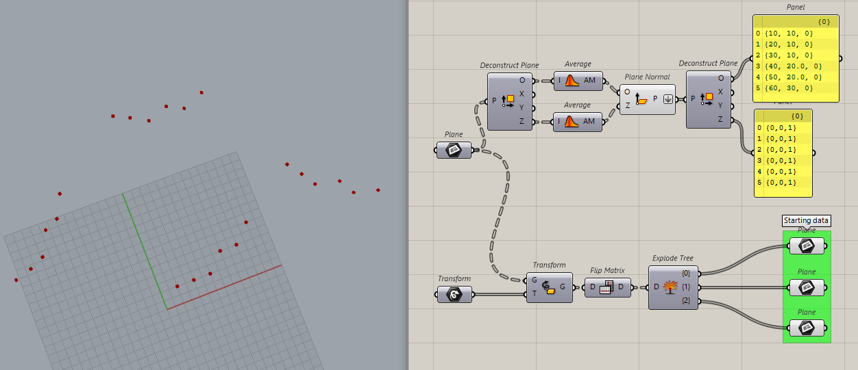

I have a problem where I cannot find a solution and neither I understand if a solution can be found.
The context is the alignment of 3d scan data. Each scan have errors, but my hope is to cancel, to “average-out” the errors by making more scans of the same details.
Here in the attached file I have 6 planes (resulting of scanning cylindrical elements).
I have prepared the data as if the scan was made 3 times.
If the 3 scans are already in the correct place, you can see how the simply average of plane positions and Z axes perfectly achieve the original data (round integer positions and perfect Z direction).
(I do not care for the X and Y direction, just the planes origin and normal, Z axis)
Now, creating a more realistic scenario, I randomly rigid-move the 3 sets of 6 planes.
I expect it should be possible to re-align together the 3 sets, rebuilding the correct relative position of the planes and relative direction… but I can’t find a method that do that correctly.
I always get some remaining error…
alignment of sets of planes.gh (14.8 KB)
The actual starting data is from the green group.
Thanks in advance!

The relative position between the 6 planes of the example should be the same as the ones created by the two average components in my definition, they fall exactly at 10,10 20,10 30,10 etc etc…
Your solution create different relative positions..

there are a couple of things I tried, sharing here just for reference, the first idea was -of course- the noob brute-forcing galapagos approach, using xyz sliders for translation, and xy, zx and yz rotationin, in such a way to try to bring two out of the three set of planes to overlap the first one
weird stuff going on of course, the precision depends on the decimals of the sliders, using degrees instead of radians helps on that matter, but at the end of the game the real problem is the fitness: how to define/evaluate a good result?
I thought a good way would be to check the sum of the vector_Z of each of the 6 plane triplets: those had to be parallel to each other (or as parallel as apossible)
then I thought “hey, but why galapagos if we can Kangaroo!!!”, and did a weird thing with rigid points, and Line connecting triplets of planes that had to go to length = zero… and then (it was already the second day of experiments) I thought “let’s check the inverse transformation of those planes”, and saw that the triplets do not share the same origin point of course :slight_smile:
so everything I tried was bad and wrong :slight_smile:
