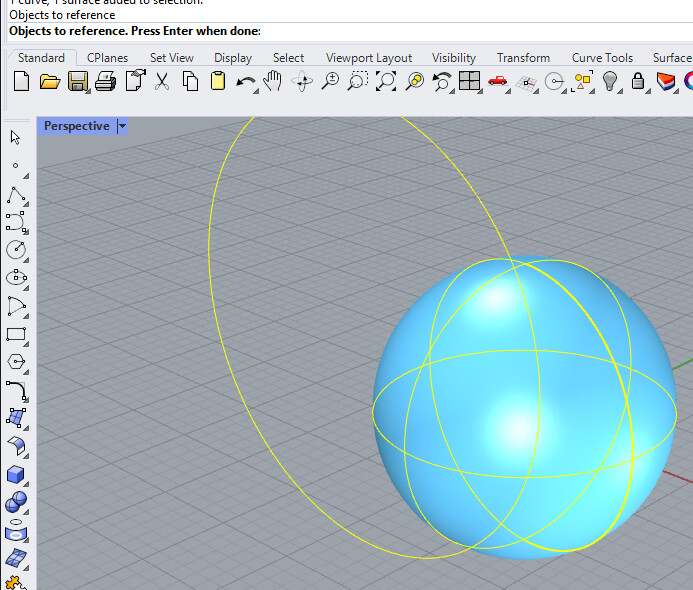

Hi Andrew -
If your object already is a mesh object, right-click on the Mesh parameter at the start of the definition and pick Set one Mesh.
If your object is a NURBS object, you can drop a Brep parameter on the canvas, right-click and Set one Brep and then connect that parameter with the existing Mesh parameter.

Great - thanks @wim I have got that working - fantastic… : ] and that works well with the prep function as I am working with nurbs objects…
One thing I am trying to figure out - is the object that I am dropping, is an assembly of objects - and so I would like all of those items to stay together as they drop and not change positon in relation to the assembly - do you know ho I can do that apart from maybe boolean union all the ‘parts together’?
One option is to use ShrinkWrap to combine the objects for the calculation. You can still get the Brep objects out at the end like this:
