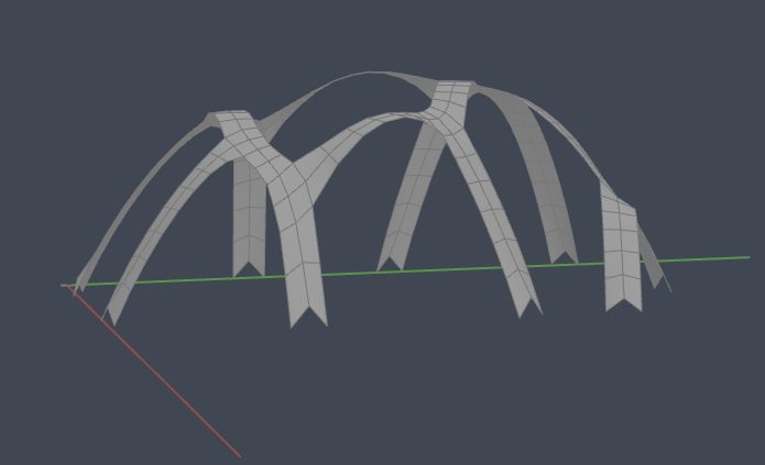

Here is the real mesh I like to add loop cuts while thickening.
I like to add multiple loop cuts.

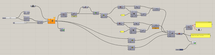

Mesh+ might have a mesh loft component. Not sure about it since I do not use the plugin anymore.

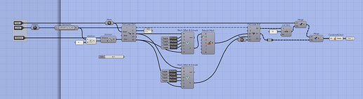

Weaverbird has a mesh from lines component which can be used to build the walls using the boundaries of a series of offset meshes.
wb_offset_mesh_loops.gh (27.9 KB)
Thank you very much! @martinsiegrist It’s indeed a good method. I searched Mesh+ Weaverbird and other plugins, but none of them can provide a simple solution.

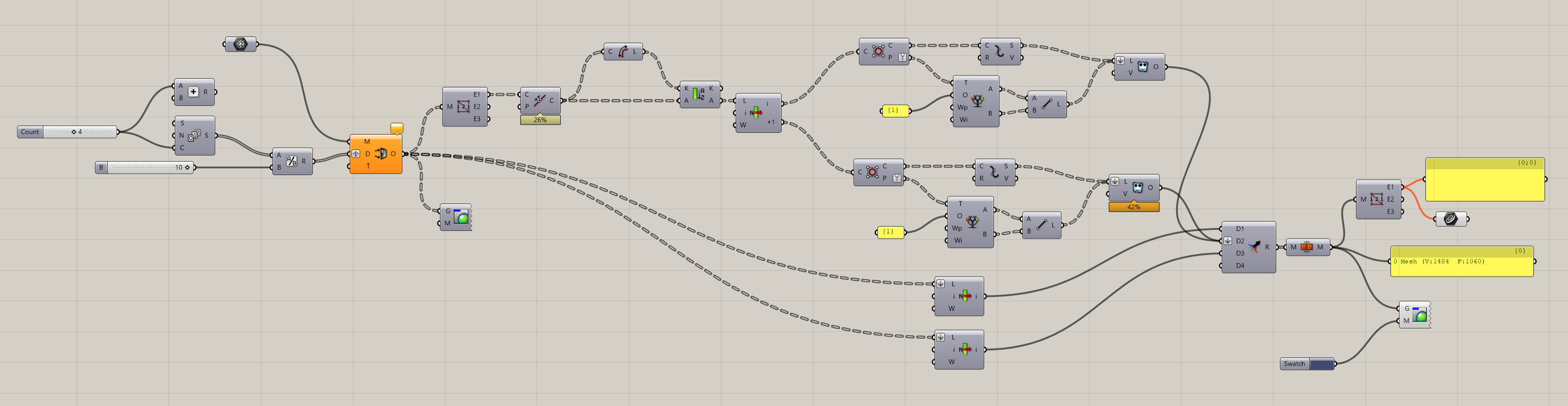

Offset Loop Cut.ghuser (13.8 KB)
Offset Loop Cut Test.gh (39.7 KB)

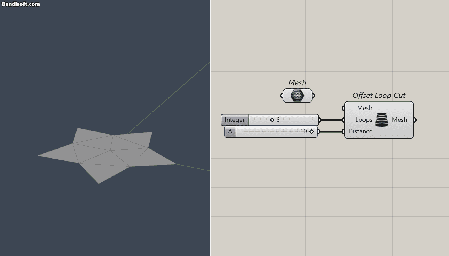

I made a simple User Object to solve this. Offset Loop Cut.
It requires Anemone and Pufferfish.

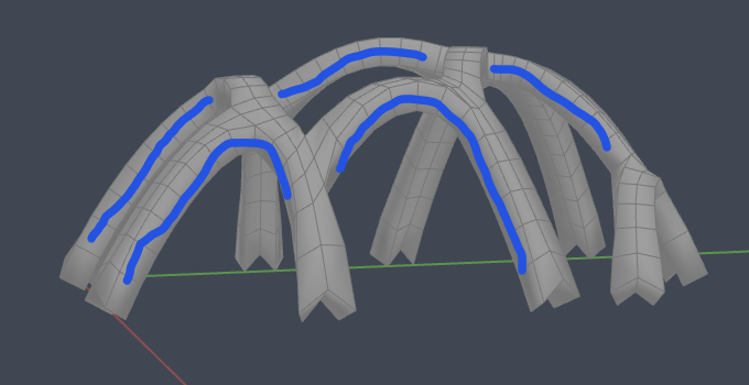

In order to control the crease(roundness), the supporting edges need to be added.
My method above has two drawbacks,
first, it adds unnecessary loops to get close to the edges needed to be creased. I guess I can solve this by tweaking things inside Anemone.
Second. It adds supporting edges only on one side of the edges that need to be creased. As shown below, the other side also needs to be added, namely the inset of the top face in this case. I like to ask if there is a way to do that in GH.
