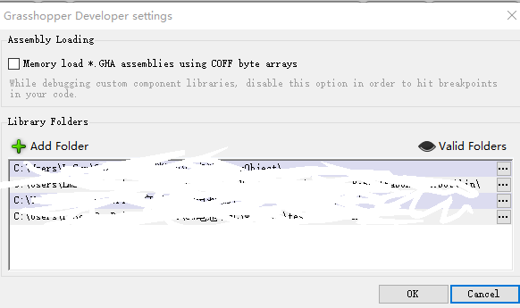

this is the default folder of userobjects,but in sometime i want to add a custom folder to put the userobjects,like the the same way as gha component folder:
%E5%9B%BE%E7%89%87
but after i tried,i found that the it is impossible to add custom userobject folder…do you have some idea?

UserObjects should be loaded from all folders containing Rhino plugins as well. So I guess you could create a blank plugin and tell Rhino about it.
%E5%9B%BE%E7%89%87
David,i move the Userobjects into plugin folder,but no works.
You need a manifest.txt
Okay, I’ll have to look into that. It could be that at the moment I’m only looking into RHI and/or YAK install folders.
At any rate, I guess the folders inside the _GrasshopperDeveloperSettings command should be included in user object search.
