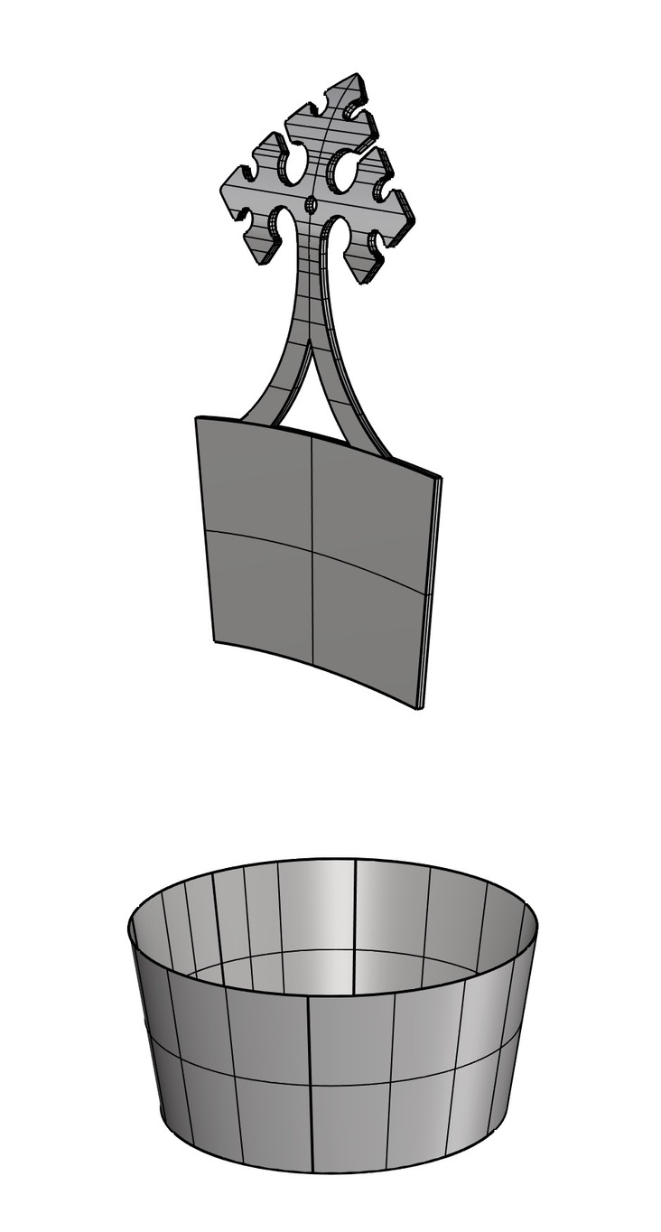

Problem #2. I’m hoping you happen to know how to deal with this one as well:)
Same thing… a crown… except this time the cylinder spreads out.
I cut it into 4 pieces and used one of the pieces to create into the crown. (top)
Now, I would like to flow that along one of the 4 cylinder pieces and copy it 3 more times so that it creates a crown.
The issue:
I can’t use “Line” like you suggested because the bottom of that piece is not a straight line this time. Would you know how to tackle this one? Thank you.
This is totally faked, but it explains how it needs to look and what that 1/4 of the cylinder looks like as well.
