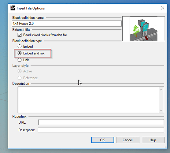

How can I embed and linked the file??
Run the insert command. Select the file to insert and click OK. The Insert File Options dialog will open. Select embed and link option:
