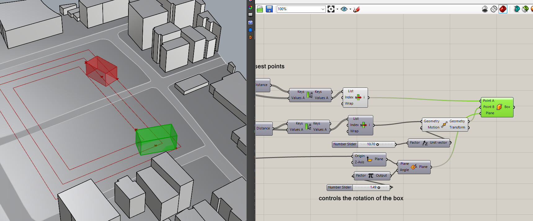

Hello, I want to rotate the cubes in the shape on the 2 curves I showed, of course, this will vary depending on the performance data, but I could not do it. Can anyone help? You can find my rhino and gh files in the attachment.

hello. i’m guessing your intent a little bit.
but check the gh file i uploaded.
the basic reasoning is this. i create a middle curve. i extract a point at that middle curve, and a tangent.
i rotate the tangent between 0 and 2Pi → and use the point and rotated tangent to create a plane.
i intersect the two boundary curves with that plane to get the intersection points → then i select the closest 2 points. finally i displace 1 of them to the desired height
then i create another horizontal plane, and rotate that to my liking → i use that plane together with the two points to create a rotated box.
Hopefully this should get you on your way.
edit: if you want to use your method of extracting points → simply copy the part of the above gh file where the box and the plane is created to get the rotation functionality
