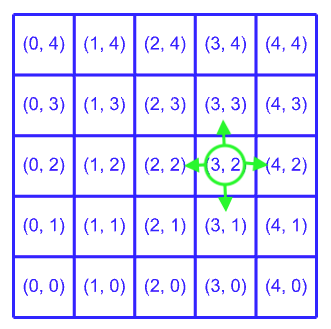

Concerning your code, I guess you could speed it up a lot, by getting rid of stuff like this:
![Screenshot 2022-04-06 at 08.19.26](https://global.discourse-cdn.com/mcneel/uploads/default/original/4X/5/e/d/5ed12c185432a26d1694bc4b694c3c8b63bd9143.png)
The issue is that you’re performing hundreds or even thousands of point in curve searches at each iteration of the game, which is very expensive and unnecessary.
Let’s say you have a simple square grid, where each cell is indexed, has side length 1, and has an on/off state. It’s really all you need, and can be a simple list with booleans:
![Screenshot 2022-04-06 at 08.29.01](https://global.discourse-cdn.com/mcneel/uploads/default/original/4X/3/4/9/3492711fbff1dd273ecb8e5ca5baac84f85796bc.png)
Now let’s say you want to get the normalized (x, y) coordinates of the cell at index 13.
`row = floor(index / number of columns) = 13 / 5 = 2`
`column = index % number of columns = 13 % 5 = 3`
Since, the initial grid is normalized, meaning each cell is 1 by 1 units in size, you need to multiply the row and column values by the real side length to get the bottom left cell corner point.
You can also get the index of a cell from its normalized (x, y) coordinates:
`index = column + row * number of columns = 3 + 2 * 5 = 13`
Now, to get a cell neighbour, all you really have to do is subtract or add one unit to the row and/or column your currently at. Here the benefit of the normalized grid is clearly discernable.
![Screenshot 2022-04-06 at 08.51.51](https://global.discourse-cdn.com/mcneel/uploads/default/original/4X/4/5/e/45ee7a414471ab20d28fe6383593a2840d3f321c.png)
`northern neighbour = (column, row + 1) = (3, 2 + 1) = (3, 3); if row + 1 < number of rows`
`eastern neighbour = (column + 1, row) = (3 + 1, 2) = (4, 2); if column + 1 < number of columns`
`southern neighbour = (column, row - 1) = (3, 2 - 1) = (3, 1); if row - 1 >= 0`
`western neighbour = (column - 1, row) = (3 - 1, 2) = (2, 2); if column - 1 >= 0`
Once you have the normalized (x, y) coordinates of a neighbour, you can again get its index and thus state by simply applying the above formula:
`western neighbour index = 2 + 2 * 5 = 12`

Interesting… I think this is exactly what I’m looking for.
It’s dificult, as an architect, to stop looking at problem solving through a more math oriented solution, instead of a visual/geometric approach.
I will definitely dive into this method to optimize this script. And take it into consideration for future projects.
Thank you!!
