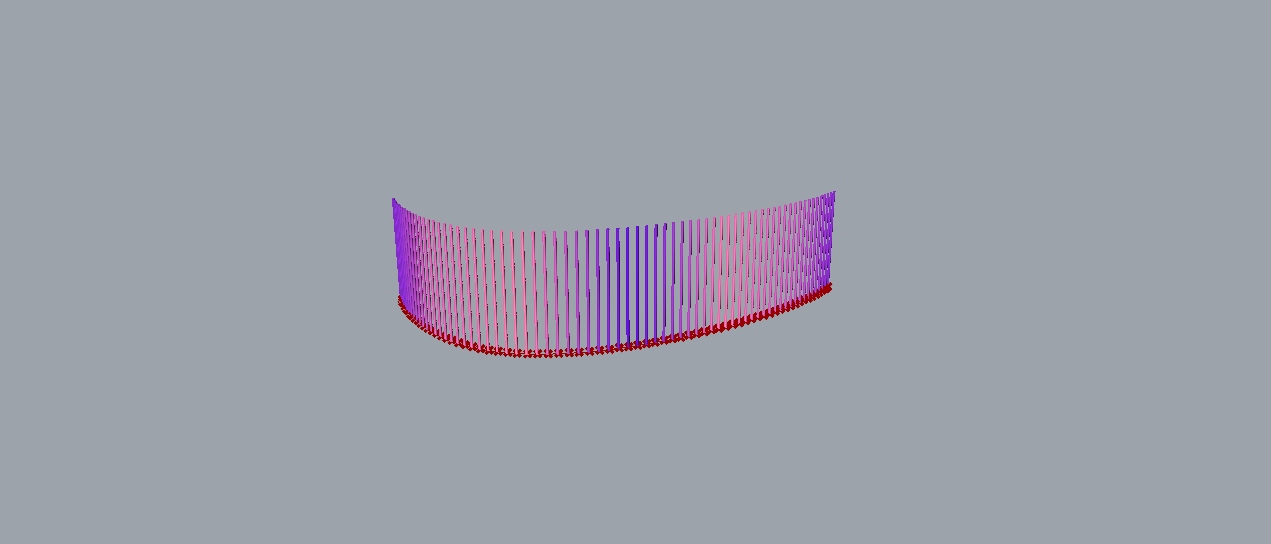

How can I achieve gradient by z axis on pipes
Hello everyone, as I mentioned earlier, this issue has been a source of perplexity for me over a considerable period, and despite multiple attempts, I must acknowledge that they have all yielded unsuccessful outcomes. I just wanna the same effection from the picture.

Anyway: there’s add-ons used so I can’t see a thing (I never use add-ons other than K2) So you want to “group” your pipes consecutively (i.e. create a Tree out of the List where max items per branch are N) and apply a gradient preview color per branch OR you want to relate the gradient previw to some other pipe property? (like length (not rational for this case), base.Z etc etc).
Regarding moved point as the critical point, the lower part is left color on gradient, the other is right but the middle part (critical point) still has gradient. I don’t know my description is clear or not.
No (what means moved pt/ critical pt ???).
Let’s talk about any tube: this has an index (from the crv division) and belongs to a branch (from the partition). So what exactly rule have in mind? (including - or not - some tube translation in Z).
Sorry about that.Please see the color of pipe which have a left-to-right gradient effection,I just wanna the color transitions from low to high.
You mean that you want a result where the gradient applies to the SAME pipe from pipe base to pipe top? (if so what’s the meaning of partition?)
Yeah,that’s my desired result.But it needs a little difference, color gradient on every pipe is same like my upload picture.Pink on pipe is less by less.

I am sorry, it’s my fault for the poor description. The gradient color does not follow the curve; it is applied to the pipe itself, like the picture I uploaded. The gradient color on the pipe runs along its height.

Like this?
gradient RWG.gh (11.3 KB)

Anyway I don’t have anything from these. But she wants this (in Z instead of the shown Y):
PS: Obviously you can do a Mesh and assign gradient Colors to Vertices … but that’s a poor man’s solution.

Like this.It was made in Max, I am wondering how to achieve this effection in rhino.But there is a little difference, the bottom color is more by more from left to right and the top color is less by less from left to right.

maybe this? A or B?!
gradiant-intA-B.gh (26.7 KB)
2-3ms for a reasonable Mesh + 20-50ms for placing about 500+ Instance Definitions around: i.e. date a girl ONCE and then date the replicas.
To do: Bake, define an ID and then place it 500 times to see what I mean (plus save the R file to see the other obvious thing).
But using Meshes for this puzzle is kinda going from DC to NY via LA.
Mesh_GradientVertexColors_EntryLevel_V1.gh (319.1 KB)
