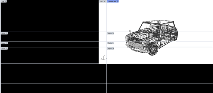

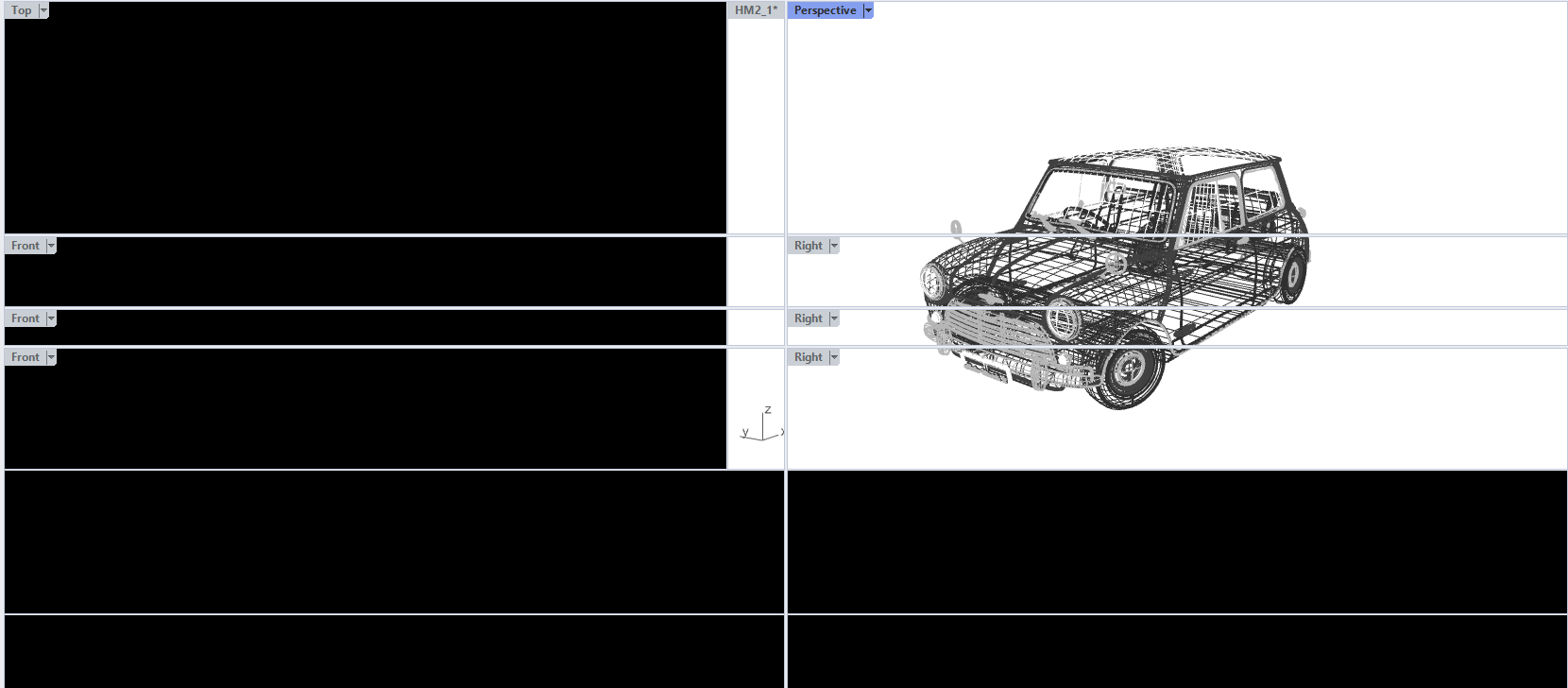

Ok, just to add some infoā¦ when I launch the command, in the command bar appears the text:
Rhino 7 sr 0 64 bit Preparing Holomark 2 R6 v2, 61
and then I get the Warning message who tells me to close and save the document. I press ok and then everything works fine. Just I donāt get the final report. I could extrapolate the info form the command line and rewrite them in the correct order, but I donāt see a total score to compare it with other machines.
Another comment.
Now the test has just finishedā¦ I guessā¦ In the command line I have:
GPU_13 Test took:0.06 sec @ 1666.7 fps.
your system handled 110 units before dropping below 15 fps.
and again, the rendered minicooper in a HM2_1 vieport.
Donāt know what to do and donāt know if the test has actually finished.

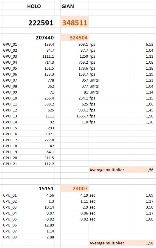

Good morning,
I tried to do what in my possibilities to reconstruct the Holomark report.
This is the outcome:
GPU_01 :9.09 sec @ 909.1 fps.
GPU_02 :1.14 sec @ 87.7 fps.
GPU_03 :0.08 sec @ 1250.0 fps.
GPU_04 :0.13 sec @ 769.2 fps.
GPU_05 :0.56 sec @ 178.6 fps.
GPU_06 :0.63 sec @ 158.7 fps.
GPU_07 :957 units before dropping below 5 fps
GPU_08 :377 units before dropping below 5 fps
GPU_09 :81 units before dropping below 5 fps
GPU_10 :0.34 sec @ 294.1 fps.
GPU_11 :0.16 sec @ 625.0 fps.
GPU_12 :0.11 sec @ 909.1 fps.
GPU_13 :0.06 sec @ 1666.7 fps.
GPU_14 :110 units before dropping below 15 fps
CPU_01 :4.19 sec
CPU_02 :1.11 sec
CPU_03 :2.9 sec
CPU_04 :0.06 sec
CPU_05 :0.02 sec
I also have these, which I donāt know what test they are associated to:
Time to regen viewport 10 times = 0.01 seconds. (666.67 FPS)
Contour: 2.76833 s
Time to regen viewport 10 times = 0.02 seconds. (625.00 FPS)
It looks clear to me that the test is not going to the GPU_15 and CPU_6. But I am just speculating hereā¦ I am sure you will be able to lee me more about it.
Thanks
This is a strange place for the test to stop.
I think your system should attempt dropping below 15fps a few times, so itās either there or that it fails at meshing the mini.

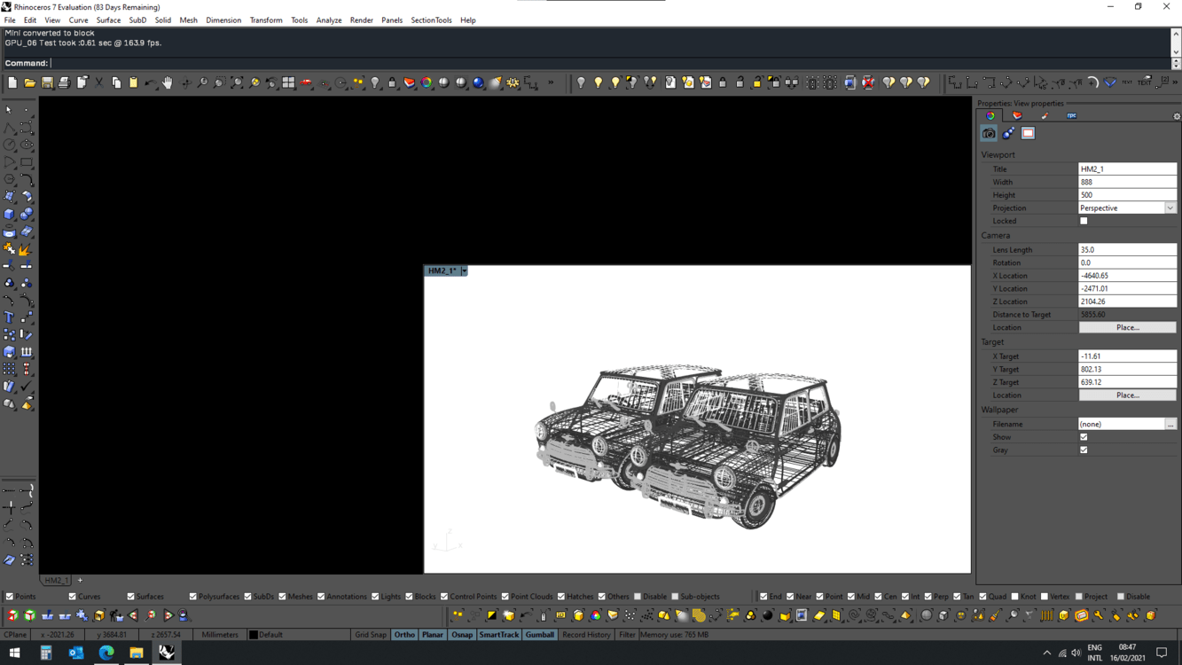

I am having a problem on Rhino 7 as well.
It just stops at a certain point, couple of times at GPU_06 and other times at GPU_13, no errors or anything.
Can not close the last viewport
Command
Creating meshes... Press Esc to cancel
CPU_03 Meshing Rhino took :2.6 sec
GPU_03 Test took :0.14 sec @ 714.3 fps.
GPU_04 Test took :0.16 sec @ 625.0 fps.
GPU_05 Test took :0.75 sec @ 133.3 fps.
Mini converted to block
GPU_06 Test took :0.84 sec @ 119.0 fps.
Your system handled 577 units before dropping below 5 fps
Your system handled 303 units before dropping below 5 fps
Your system handled 50 units before dropping below 5 fps
CPU_04 ExtractRendermesh took :0.08 sec
GPU_10 Test took :0.5 sec @ 200.0 fps.
GPU_11 Test took :0.25 sec @ 400.0 fps.
CPU_05 Joining meshes took :0.03 sec
MiniMesh converted to block
GPU_12 Test took :0.19 sec @ 526.3 fps.
GPU_13 Test took :0.14 sec @ 714.3 fps.
after this happens, trying to reset the viewport, or change the size of any of them, this happens
Same problem for me.
Itād help getting a better picture of the situation if you posted also the results of the Rhino command _SystemInfo
I have no clue on why this happens as I have never seen the trouble here on my machines.
Holomark2_R6 was built for v6, and it just install on v7 too as v7 is backwards compatible.
Maybe it would help if I recompile with the latest SR for v6 installed, but then it might not work on older v6 builds. I would prefer to work on HM7 instead of bugtracking HM2_r6 thoughā¦
Its just weird that its always either GPU_06 or GPU_13 tests

Hello, today I tried the test again, but this time it stopped after GPU_06 test
I havenāt done anything different from the last time, so I donāt know what to think about it.

The machine performs just fine, your scores are here calculated by finding the multiplier based on the tests ran and compared to my scores. (The machine I ran this on is a āsilentā configuration so not optimized for raw speed, but the numbers calculated should none the less be quite correct)
So making a good old spreadsheet to calculate the difference between yours and my scores and adjusting the scores accordingly is easy enough to do (itās just tedious). Here you go:

There is nothing, and Rhino doesnāt crash, it stops. It does not go on. It looks like the process is completedā¦
