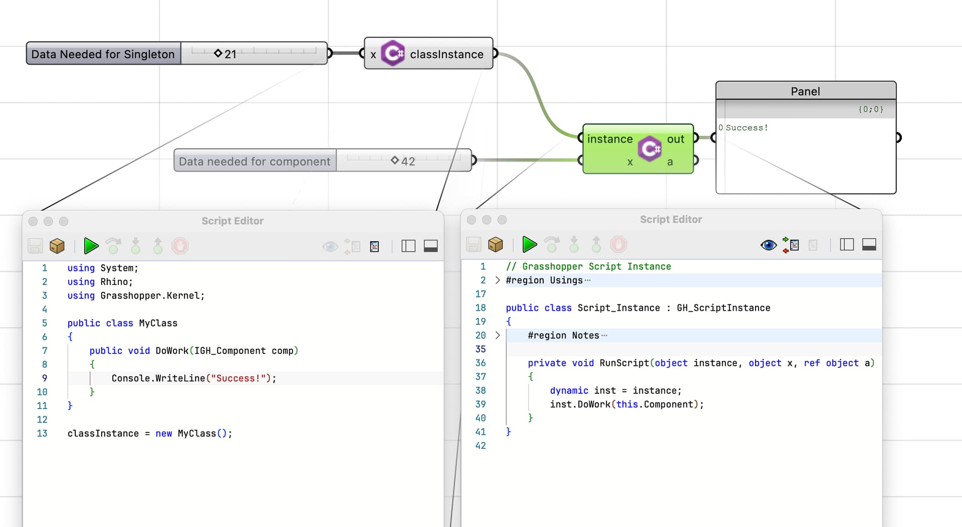

What if the object is constructed upstream and passed to the script that is working on it. Like this:
test.gh (6.2 KB)
Interesting!
Thanks!
I’ll be honest, I don’t remember the specific case for what was I needing this 1 year ago… but similar problems still occurs to me.
In the first c# script you removed the “public class Script_Instance : GH_ScriptInstance” and “private void RunScript()” sections, and built directly a class.
Then, you even used the output “classInstance” without being inside the usual “private void RunScript()” … How does it work? What’s going on?
And… a custom class/object can now exit a c# script component and go to another?
I think 7 couldn’t do this. Cool!
I’ll make some tests.
In the new C# scripting component, you don’t have to implement a GH_ScriptInstance. This was called SDK-mode on the legacy IronPython component. I made this consistent across languages. Both python and C# now support Script-mode (without GH_ScriptInstance class) and SDK-mode (with GH_ScriptInstance class).
As you know the GH_ScriptInstance is really powerful to implement before/after solve and preview handlers in grasshopper. The script-mode makes it easy to write C# code when these overrides are not necessary and you just want to put some logic together.
To match legacy behaviour, the C# component defaults to SDK-mode, and Python components default to Script-mode.
