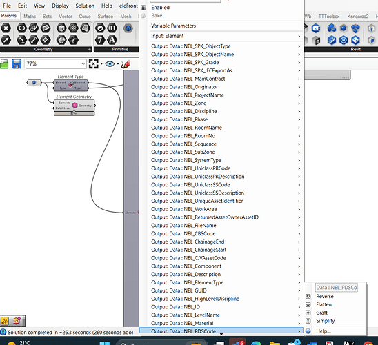

HIDE UNCONNECTED PARAMETERS issue with INSPECT ELEMENT
“I’m frustrated that I need to click the small arrow at the bottom of the window to access ‘HIDE UNCONNECTED PARAMETERS’ after selecting parameters through the ‘INSPECT ELEMENT’ component. It used to be simpler when I could right-click on the ‘Inspect Element’ component. Could someone please assist me in finding alternative methods for this process?”
Hi TVA, You can use Shift / Cntl click on the component to hide/show connected/unconnected parameters.
Does that help?
Yes, that helps a lot, thanks @Japhy
