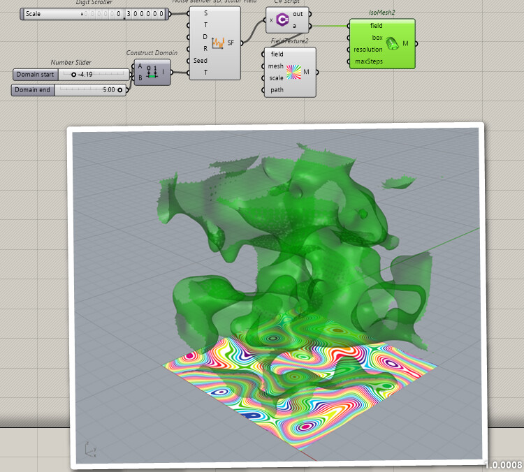

I need some help with creating a structure in grasshopper. I want to create a structure, that look like a lime stone or like a poros structure with holes. I need it to be flexibel for later adaptation, maybe somebody knows how to code that?

there are many many ways.
You could try Isopod,
Use some field that can alter a shape like showed here

I hope you are well. I began outputting Delegate Func<Point3d,double> for Scalar Fields, for vector Field I continue to output GH_Field.
Your bridge components works well.
Here some uses with Nautilus component Fast Noise Lite, Blender, Equation,
[image]
[image]
[image]
Can you add this component to a next IsoPod release ?
Thanks
