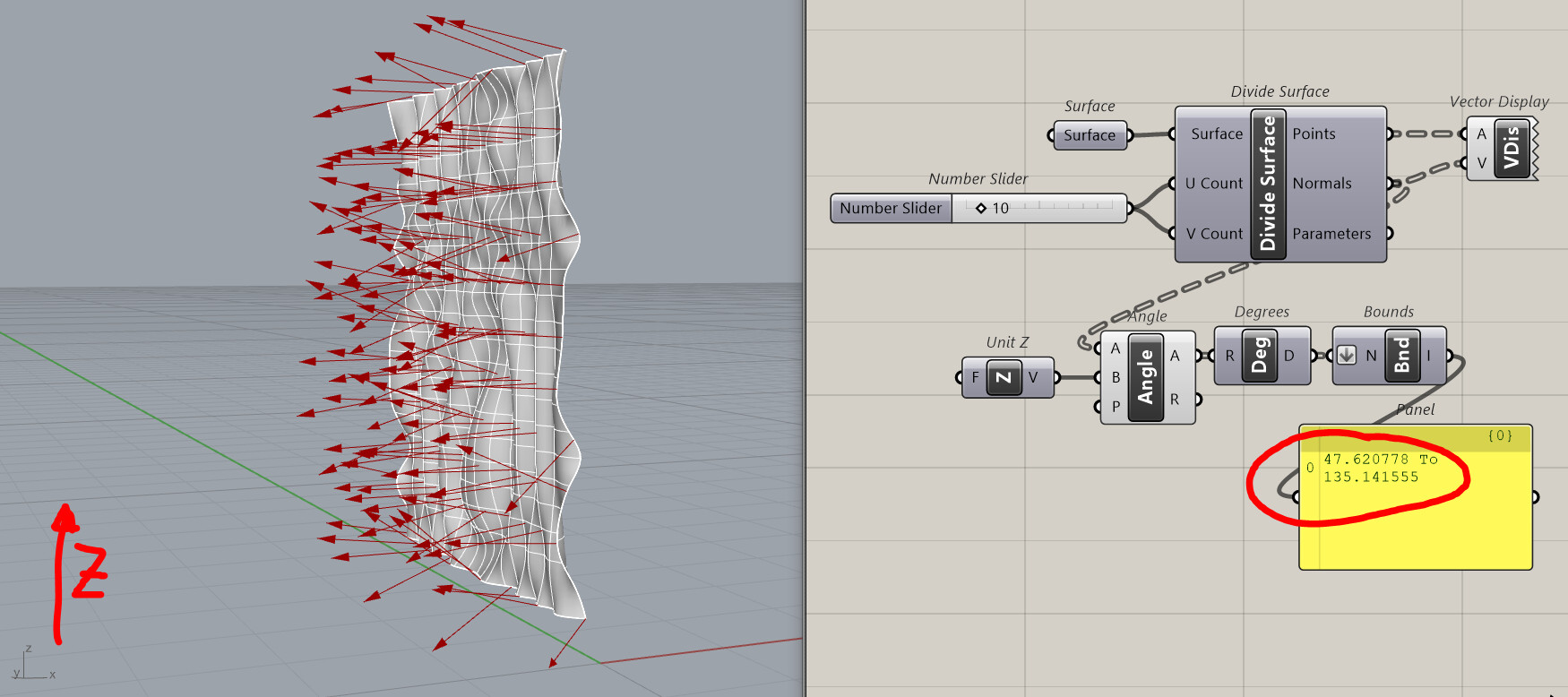

for clarity: in the example taken from your deifinition, the surface normals have angles with Z axis that ranges between 47.6° up to 135.14°: the angle is always higher than 21.8° → nothing should be printable?
I’m not really understanding the logic behind it
As said by @inno there is surely a problem with the angle logic. With your script, 0° mean aligned to Z, 90° perpendicular to Z (XY plane), 180° -Z .Angles will stay [0° 180°].

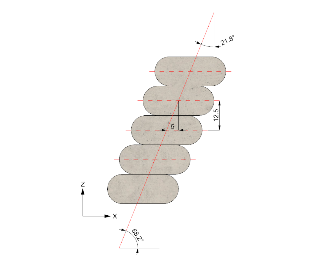

I guess i have mixed up the angles but I think this image explains what I mean.
So these represent the layers, and i want a quick way to determine w ether a geometry is printable or not either with a boolean false or true check or a visual que or both. Im not sure what am i doing wrong. Help would be greatly appreciated or at least point me in the right direction.

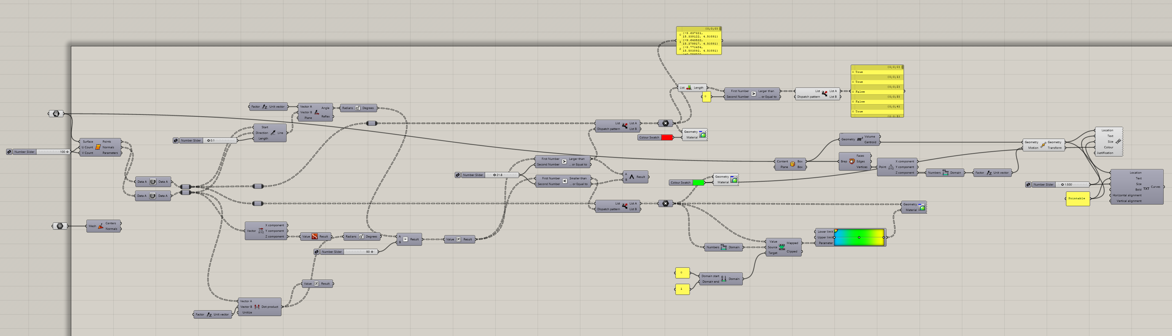

Measure Angle.gh (59.4 KB)
Managed to make it work, wanted to share it here as well!
Problem was Axis Orientation the way XYZ is handled in Rhino and a few other misplaced components!
Cheers

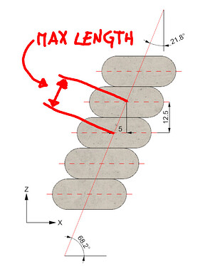

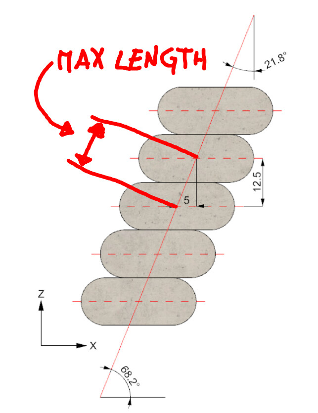

the most important thing I think is keeping horizontal rows of points at their initial Z coordinate (AnchorXYZ goal for those) and the ClampLength goal between points of consecutive layers to be this distance:
then you can set a row of point, and say you want that row to be the fixed meaning that row must be printed exactly like it is in the original surface, and everything else should become a “consequence” of that (Anchor Goal to that row, so those points can’t actually move anywhere)
