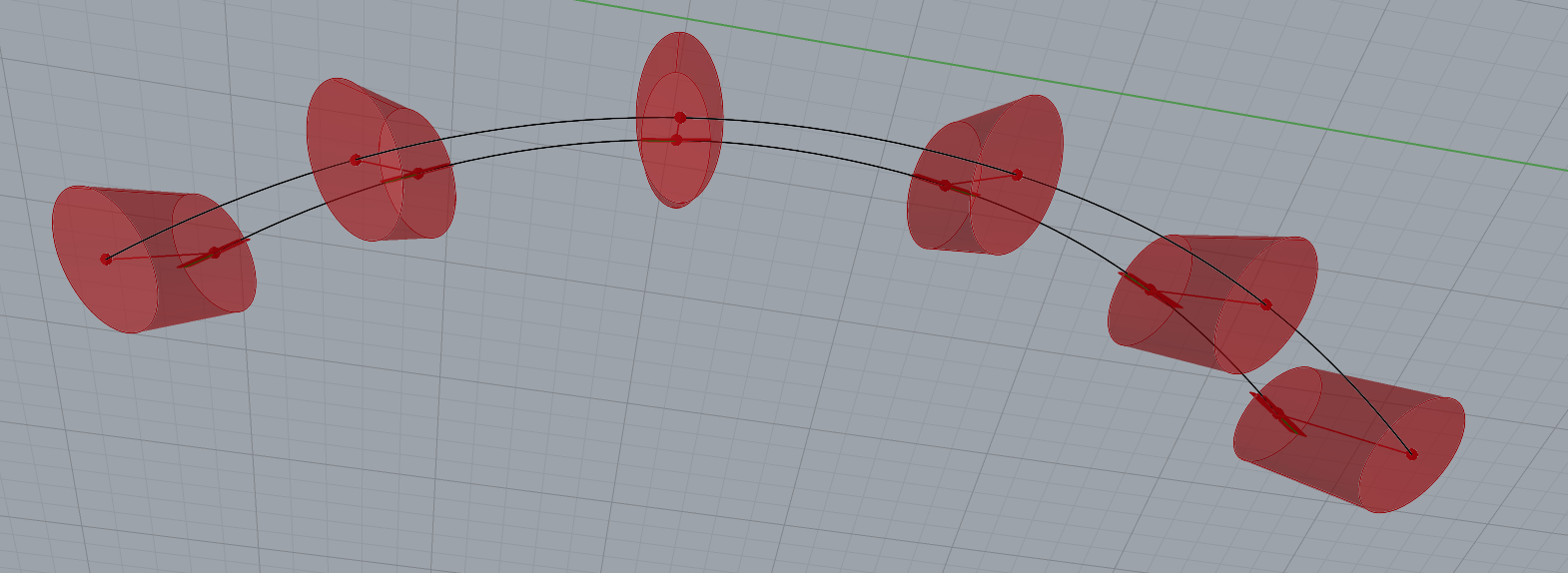

I recently encountered a problem. I want to make the ellipses on these two S-shaped curves stand out from each other while the longer direction of the ellipses can be perpendicular to the S-shaped line.
Now my ellipse stand out from each other, but the longer direction of the ellipses is not perpendicular to the S-shaped line.

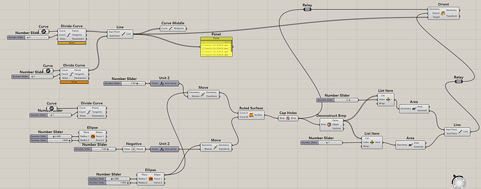

Problem was in the Orient component.
Orient needs planes as input. And then you have to create those planes the same way, so they will fit nicely in place.
For Source plan, I used one edge of the brep and the Center of Area, you already made.
For target plane it was more difficult. I started with Perp Frame, but that did not work as I hoped for. After some puzzling I used circles (but could also be done with subcurve to get points “sidewards” on the curve.
Then both where made with Plane, Line + 1 Point.
(see documentation for how this all works.
PS: With the method I used, the planes are just a bit “off”. It can be done more precise. If you need that, let us know.
PS2: Probably there are others here, what can solve this plane-thing more elegant. But it works. :slight_smile:
Advice is to place your components nicely on your canvas, so it is easy to “read”.
Delete components you do not use.
Make groups so you know what belongs to each-other.
NB: Remember a plane needs at least 3 points, or 1 line and 1 point (not in same line) to be made.
