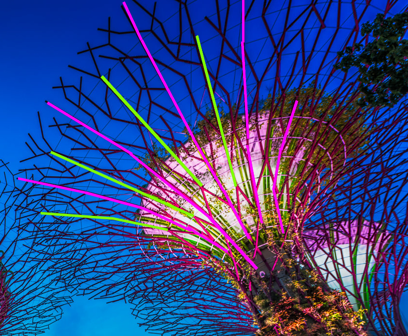

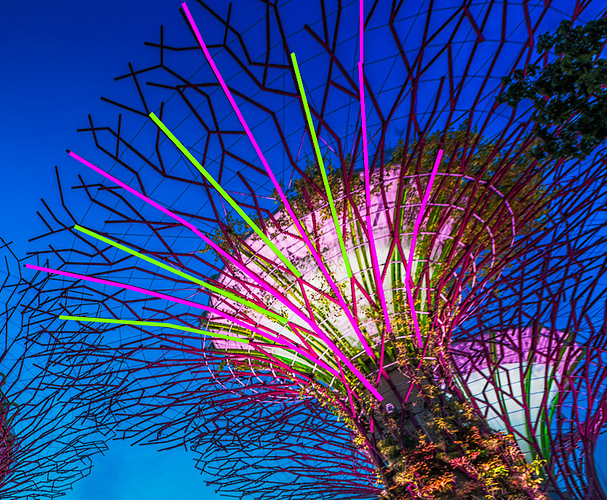

Don’t delete your post, it is quite interesting. I also found these geometries awesome. I don’t think it is fractals.
When you want to recreate something, seek for the patterns, the models … Here I see some quite vertical “lines” (one full lenght, one shortest …) and shortest walk curves merging on each “line”.
So points are affected on each lines and are used in combination to shortest walk. Look at example of that, there are many of them on old grasshopper3d.com forum
