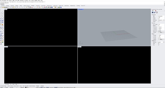

Hi, I have a problem with Rhinoceros 7. Yesterday I update my Windows and since then when I open Rhino the views are completly black. If I opend the safe mode I can see the models but only in wireframe mode.
Sry for bad english.

AMD is aware of the shortcomings of their recent Drivers in regard to OpenGL.
Go into your Options and uncheck Use GPU Tessellation, if that doesn’t work go down one notch on your OpenGL Level.
Thanks man, you saved me
