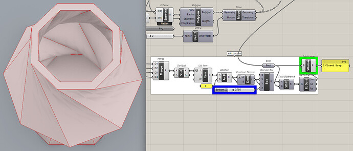

hi guys can anyone help me here. I am having trouble making the thickness for my model, I have tried to offset but it always gives error, I will do 3D printing

Have you tried Shrinkwrap?

GH way.

Make two using different radii. ‘Thickness’ slider (blue group) affects all polygons. By the way, the number of polygon segments are all set by another slider but one at the bottom had a different value from all the others: 6 instead of 8. Was that deliberate or a mistake?
vase_Thickness_2025Apr28a.gh (22.1 KB)

There are many ways to add a bottom to a “vase” like this, including an inside filet. I didn’t bother in this case (search the form), in part because I realized my code in this thread was used without attribution in a different thread :bangbang: This is hasty.
vase_Thickness_2025Apr28b.gh (23.1 KB)
