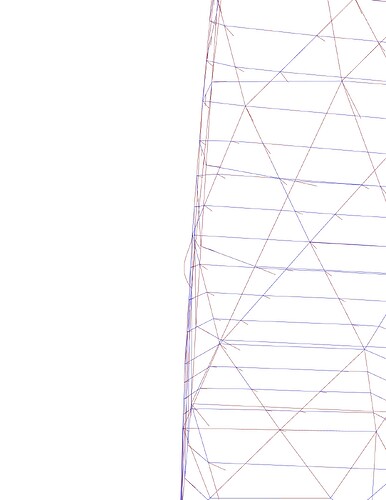

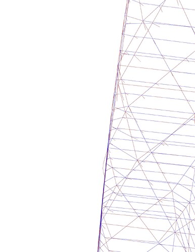

Good evening, I have some problems with this building, I noticed this when I looked at the deformation. The first is the presence of these little rotating rods which I do not think I have included in the model. The second problem is that this rod deforms in this curved way. When I use another structural analysis software, it shows me nodes that I don’t think I’ve included, which are at the end of these little rods. Can you solve the problem?
Model.gh (189.7 KB)
Hello, you have overlapping lines.
Remove the duplicate lines, the problem can be found here
Hi, thank you for your help, when i prove to remove the dublicate lines it doesn’t work, because the lines are not the same. If i prove to cancel the FL1, FL2 and Frame i’have other problems in the analysys. you can try it on my model, maybe you can do better? Thank you so much
