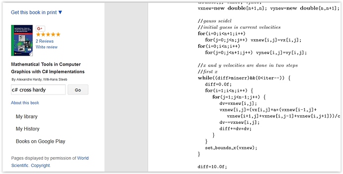

(Pfotiad0) #3
Er … let’s start from zero on that one
You want to create a full app (so to speak) using CH in GH ?? (https://cheguide.com/tag/hardy-cross/). By that I mean some kind of “all in one thingy” that does the maths/calcs AND the viz part ??.
And what sort of maths? (C#?)
http://connection.ebscohost.com/c/articles/95858535/development-source-code-hardy-cross-method-c-net-water-distribution-network
And what sort of viz part? Just a 2d graph or something other?
If yes (Note: not the ideal first time case, he he) who’s gonna use that thing?
