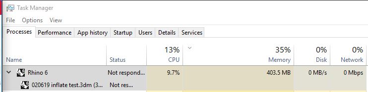

Thanks for all this. its really enlightening. I didnt realize that the ghz rating could be a total of the cores not per core… dissapointing. Based on what you guys are saying, I’m thinking that my issue is more processor than RAM. Please let me know if you think my theory is good.
My configuration:
intel Xeon dual 6 core 3.33ghz. (does this mean only .555ghz per thread?)
12GB RAM (i dont know the speed)
Nvidia quadro FX3800
attached is a snapshot of the task manager during the processing of the
 ![help_02](https://global.discourse-cdn.com/mcneel/uploads/default/original/3X/4/f/4fc7c20246768ee0702eaa1d633df4ea24cfd9fc.jpeg)
I guess the way i understand this is that grasshopper is maxing out 1 of 12 cores which would be 8.33% of the cpu and rhino is probly using another core to make up the rest of the 9.7%? its only using 403Mb of Ram so that doesnt seem to be a bottleneck. I ran it with the Kangaroo 2 solver as well but i didn’t see a difference. Is there something i need to do to allow threading?
thanks again
Michael

Sadly multi-threading doesn’t mean all cores will be maxed out all the time, or that the speed will correspond linearly to the number of cores, even if the code was completely independent parts each running on one core. Also only parts of the process are possible to make parallel, since everything needs to be recombined at some point.
It also might not make sense to focus too much on hardware here, when there are probably much bigger gains to be had by changing the definition setup. For instance - have you tried seeing how low a resolution mesh you can use for the simulation (subdividing after to make it smooth as needed)? I think you might be surprised how little difference it makes to the shape.
If the main issue is that pause when the simulation initialises, there could be room for improvement here too. This initialisation step is designed for flexibility when adding many different goals without the solver needing any knowledge about the topology of what they come from, but in a case like here where they all act on one mesh, there might be a way to skip some of the connectivity searching.

No, each thread can hit 3.33ghz, but it’s not that simple. The CPU may boost if needed and therefore be able to go above that limit (if it has this feature). It also may throttle back depending on temperatures and sit below that limit (especially if you’re using a stock cooling option for your CPU).
That 3.33 Ghz number is your single core performance, and generally speaking, 3d modeling programs are more dependent on single-core performance.
