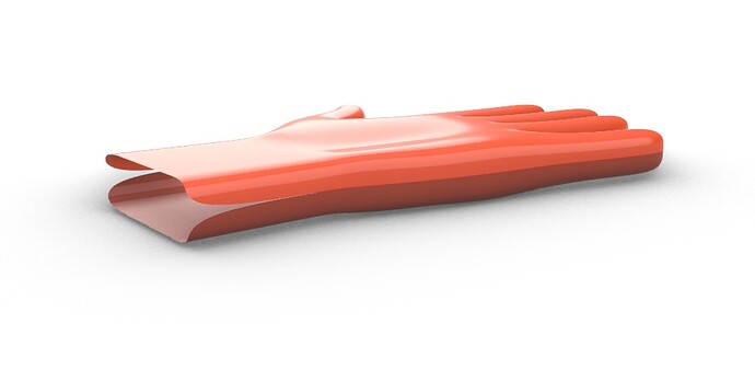

I’ve got this problem with SubD reflection option when I want to reflect any surface, I do it somehow by luck (mirror is easier since it has preview) and finally I’ve made it. but when I extend, it splits up. Please assist me to understand the problem. I appreciate it.
[Untitled.3dm](https://discourse.mcneel.com/uploads/short-url/2vhAX5Gnymw77uAaAsrAW2ds9sp.3dm) (484.9 KB)

Not sure how you exactly extruded that, but you have some overlapping geometry. I think you may have made a poor selection when starting to extrude, and did it several times.
Remove the extruded part, including the extra two faces and extrude again:

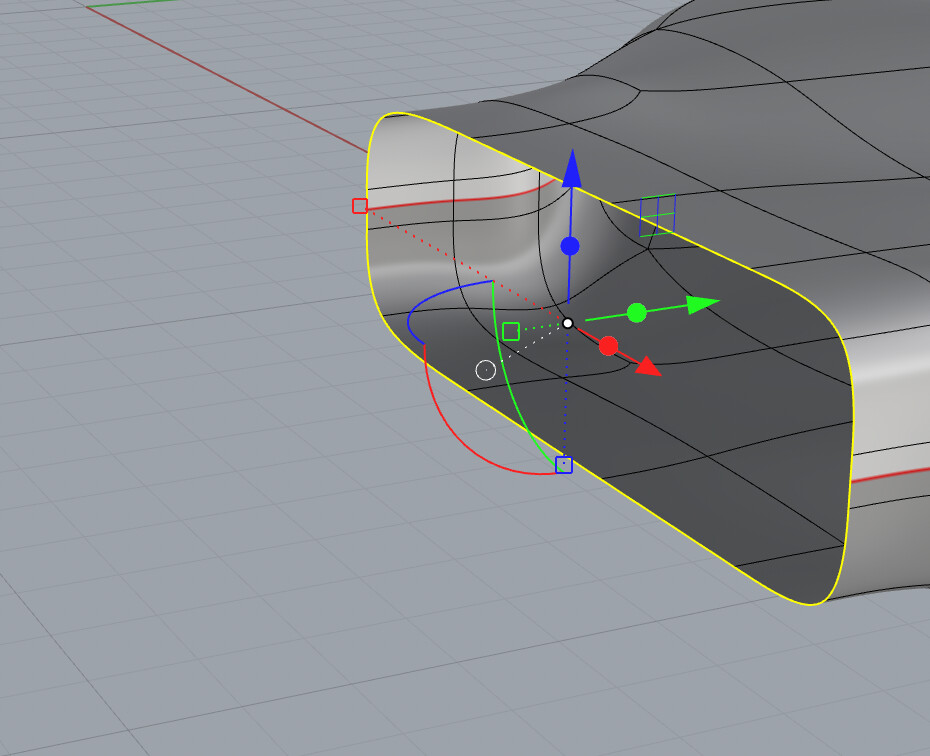

\_SelEdgeRing on bottom and top
 ![kuva](https://global.discourse-cdn.com/mcneel/uploads/default/original/4X/1/0/5/1056419bf24b5dc2c0b6b0f52f282fc1d721ee30.jpeg)

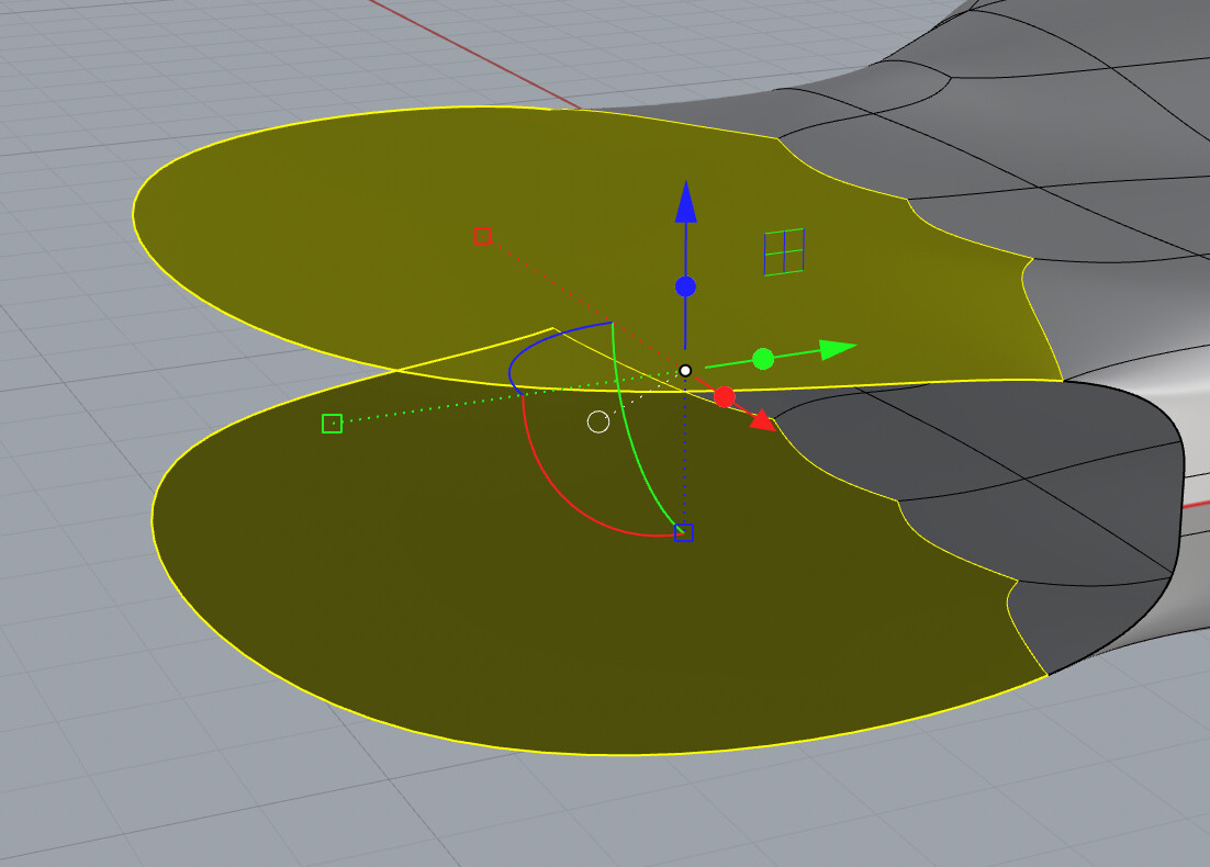

Delete the selection
 ![kuva](https://global.discourse-cdn.com/mcneel/uploads/default/original/4X/7/e/e/7eeaefe6d4f5dbe86630b1e9380ed2e1ed23dec3.jpeg)
Sub-object select the two faces (ctrl+shift+click or cmd+shift+click)
 ![kuva](https://global.discourse-cdn.com/mcneel/uploads/default/original/4X/9/d/5/9d574940c96f15d8824f304430c7e21741635495.jpeg)

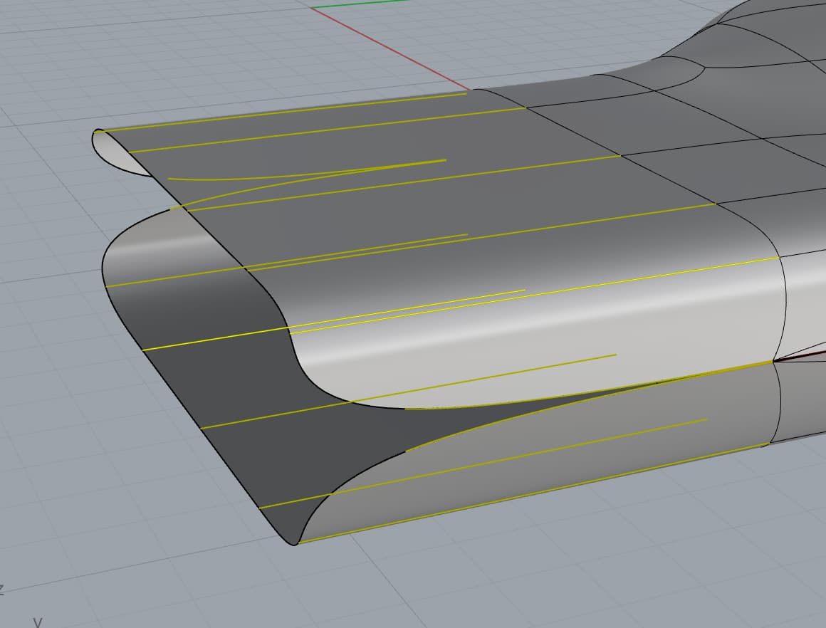

 ![kuva](https://global.discourse-cdn.com/mcneel/uploads/default/original/4X/0/c/8/0c8679a313603d5d6d21edc51cd817880ccea6d0.jpeg)

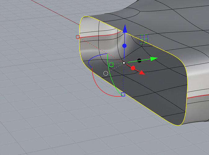

Sub-object select the edge (ctrl+shift + double click, or cmd+shift+double click)
 ![kuva](https://global.discourse-cdn.com/mcneel/uploads/default/original/4X/d/b/e/dbe6eb0033af58fabc9ee0c893ea68bf92958851.jpeg)
Extrude with the dot on the green gumball axis
 ![kuva](https://global.discourse-cdn.com/mcneel/uploads/default/original/4X/c/0/1/c019eb8357d7ab68fdb05a6014f42a63589a8448.jpeg)
 ![kuva](https://global.discourse-cdn.com/mcneel/uploads/default/original/4X/2/a/9/2a9e60e6d5f99543910894b3c338a392365d5810.jpeg)

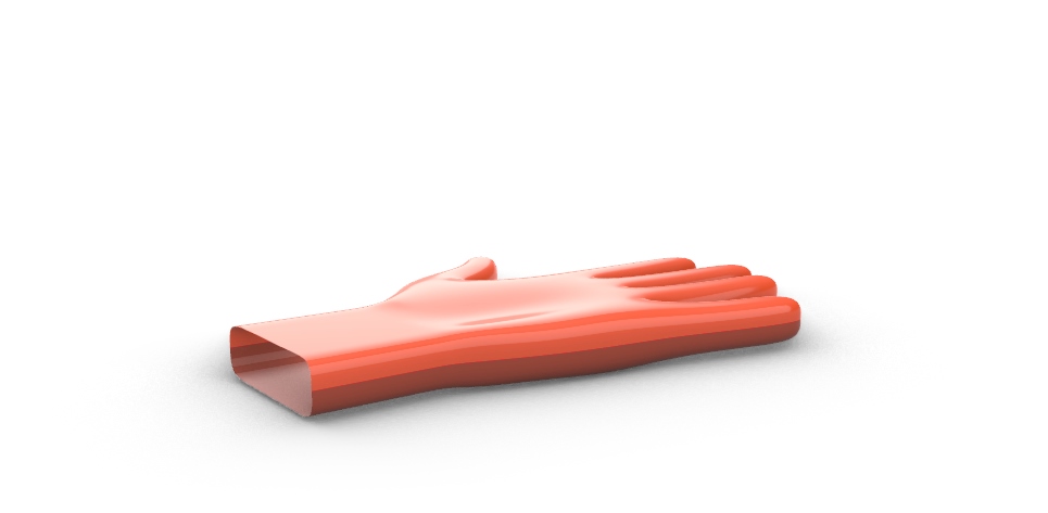

Thanks JesterKing. That’s really helpful. I don’t know how I came up with that (out-of-shape) shape, but I’ll try what you’ve just told me. I’ll try to make it following your steps. Please give me the credit to get back and ask if in case I couldn’t make it. Thanks!
 ![ViewCapture20210725_154206](https://global.discourse-cdn.com/mcneel/uploads/default/original/4X/c/7/1/c71276cccc205a47f62305be3922be086992b13e.jpeg)
Edit: Just made it! awesome. Thanks JesterKing
