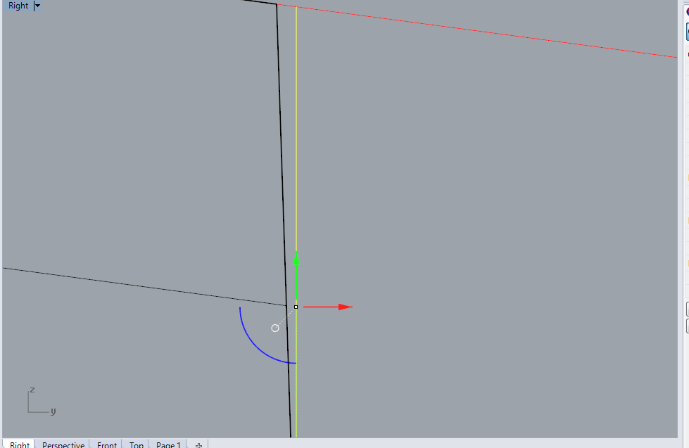

So I seem to be missing the planer drag for the gumball, and can’t see to get it back.

Hi Dennis- is this true with any selection?
Yes curve,surface or polysurface in any view.
First thing I would check is the status of my display drivers; try and update those as a first elimination of possible causes.
-Willem
Yep driver up to date. Still no change. I started noticing it when after I updated the newest service pack, but couldn’t definitely tell you unless I re-installed the older version.
Fixed it. I went under the gumball settings, restored the defaults, and it’s not back. Which is strange because I never changed any of the settings to begin with, I am guessing something happened during the updating process.
