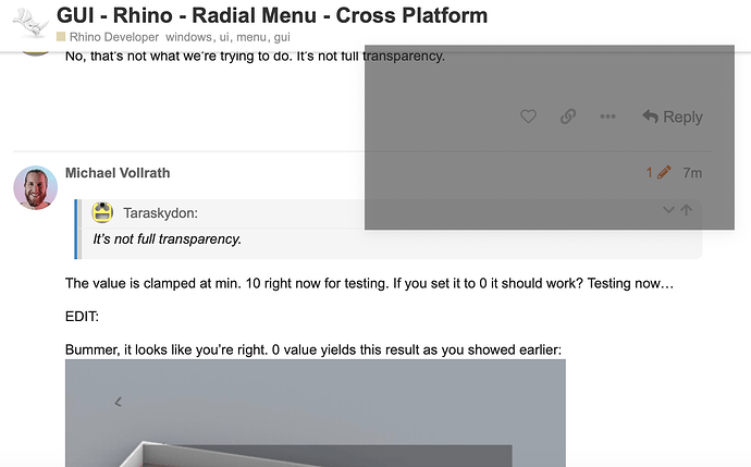

Hi everyone @antoine @mrhe @taraskydon @clement ,
Made a little progress on this today (I think).
This code is based on previous code from @Mahdiyar in this post:
I modified it to hide the menu bar/title bar and we now have a basic “transparent form” to work with.
Can a Mac OS user test?

Rhino_KO6cc0KkaA
No, that’s not what we’re trying to do. It’s not full transparency.
The value is clamped at min. 10 right now for testing. If you set it to 0 it should work? Testing now…
EDIT:
Bummer, it looks like you’re right. 0 value yields this result as you showed earlier:
I see the issue now
actually working on Mac, but same grey result…I only keep the layout that why there is only a grey square
@michaelvollrath, i can just give a small hint what i’ve found out so far to make it work under windows and partially for mac:
  1. It must be a Eto.Forms.Form, an Eto.Forms.Dialog does not work
  2. WindowStyle must be None
  3. You don’t need to change Opacity (but can if you like it semitransparent).
  4. The Style must be applied as in @mrhe’s example code
